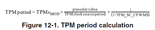

HEllo,
in the KLQRUG app note this frequency this formula is given:
so for CenterPWM the TPMPerio=  (MOD x Tmie Step) / 2
However this does not make sense to me. From the datasheet:
so I would think for CPWM T=  (MOD x time Step) x 2
Can you confirm if there is an error in the appnote?
Thanks!

I aggree with you  and I've reported the error of KLQRUG now. Thanks for your question.
