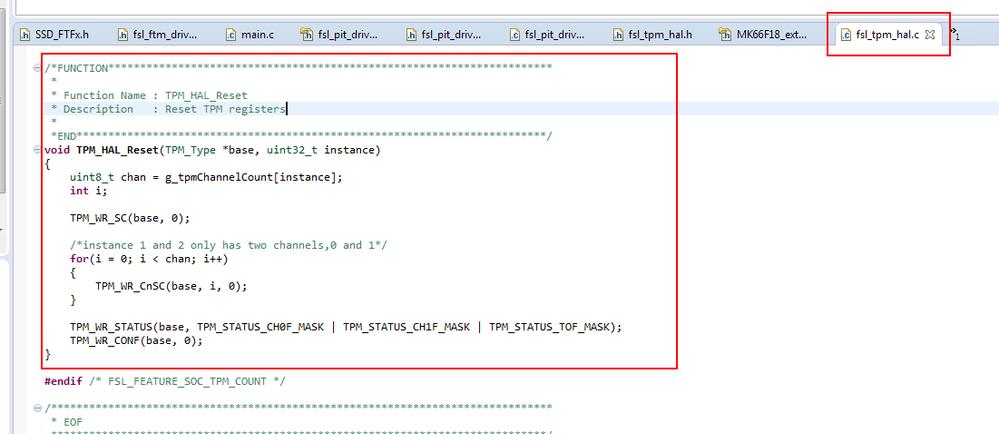

Hello Calvin,
There is a reset function you can use :
Alice Yang

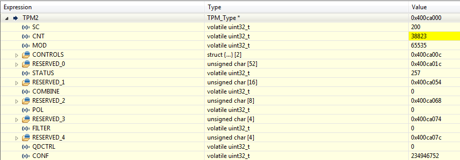

Before TPM_HAL_ClearCounter(TPM2);

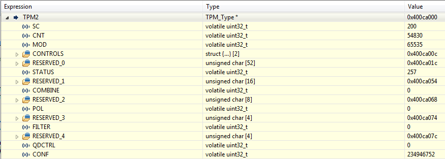

After.

43.4.2 Counter (TPMx_CNT)
The CNT register contains the TPM counter value.
Reset clears the CNT register. Writing any value to COUNT also clears the counter.
When debug is active, the TPM counter does not increment unless configured otherwise.
Reading the CNT register adds two wait states to the register access due to
synchronization delays.

Hi Calvin,
Can you show me a dump of the TPM module registers? Did you see CMOD bits set for TPMx_SC register?
Hao
