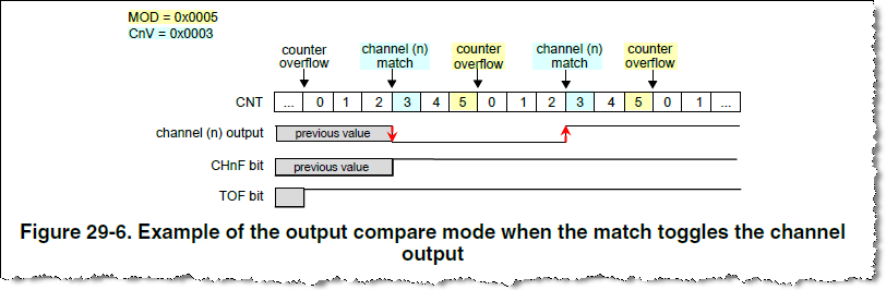

Robin_Shen
Hi Attilio,
I can see you configure the TPM0 work as OUT_COMPARE_TOGGLE mode.
Since you just need the ch2 get an interrupt break at every 1ms, why not direct configure TPM0->MOD let the period =1ms. Then the fixed TPM0->CONTROLS[TPM_CHANNEL_2].CnV value will always get 1ms interrupt and toggle waveform.(There is no need to modify ch2.CnV so frequently in IRQ)
Example of the output compare mode when the match toggles the channel output.png
Robin

Robin_Shen
Hi Attilio,
I find the value that you give CnV will greater than TPM0->MOD = 46750;
Please limit the value of CnV.
Robin
