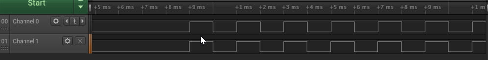

I tried to replicate this in the TRK-KEA8 but I couldn't do it, in my test the signals are shifted by some microseconds, this is the signals that I capture and as you see there isn't any perceptive delay:
The delay is around 13 us between the two signals:
pastedImage_2.pngYou can check my code below. This is using the S32 Design Studio IDE.

1. Can you let me know how are you measuring this time?
I do this by measuring the GPIO.I set PTB4 at the end of initialize code and toggle PTB4 in the systick timer interrupt handle function.
