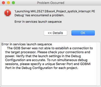

I am trying to implement a Systick exception handler that can flash an LED on the FRDM KL25Z board.  The code compiles but when I go to debug it I get the following error: "Error in services launch sequence"
The code is intended to flash an LED on the FRDM board around 1 Hz.  I've been able to poll the SysTick without using exceptions/interrupts, but for whatever reason I am missing something while setting this up that blocks execution.  I'm trying to write code that is as CMSIS-compliant as possible, so no KDS calls.
If anyone has a hint about what I should be doing differently with setting up the SysTick exception, I'm all ears.  Code below...
Thanks!
James

Hi James
Here is a 1ms SYSTICK interrupt and handler (works on any Kinetis part):

Your problem looks to be a debugger issue - try loading a binary at these links or using the uTasker's KL25 simulator.
http://www.utasker.com/kinetis/FRDM-KL25Z.html
http://www.utasker.com/kinetis/TWR-KL25Z48M.html
However, your handler is not resetting the Systick interrupt flag which would mean that it would never stop firing.
