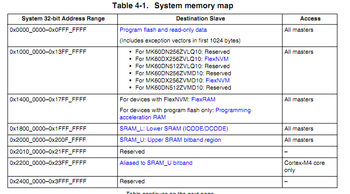

I would like to ask you some more question. I'm used to work with .LCF and .PRM files, where the segments are defined. Now I can't find the equivalent for the Kinetis. I'm using IAR Workbench.
- How can I tell where does the FLASH begins/ends? Where can I modify that?
- What's the samallest partion that I can erase(1kb?) and How can I do that? I mean, I've seen the "FlashEraseAllBlock" rotuine but I guess that erase ALL the flash

Paul_Tian
Hi, Sebasria
1. For flash memory, you can reference this picture.
2. Yes, it is 1K. I will provide a simple sector erase function "FlashEraseSector" for your reference as attached.
3. If you did flexNVM partition operation, you need to re-init flash. If you do not do this operation, of course, you need not.
