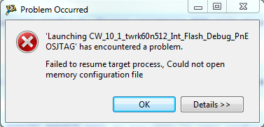

Ok so I switched the the K60x512, because we had an extra one in the building.  Also, I was reading the AN4452, which seems targetted toward the K60.  So I decided to give it a try.  The program compiles and all, however when I click debug, and wait for everything to load, I get an error. 68-Capture.PNGThis one to be exact.   I am not quite sure where this problem came from, and how to fix it.  I googled it, and didn't really find much.  I am going to give it a second try after writing this.  So I was hoping one of you guys would happen to know what is causing this error.  Do I need to update something, re install firmware, am I missing a jumper, or what....
What I did once I opened the K60 out of the brand new plastic packaging, was plug both the TWR-SER and the K60 into the computer, which then I used the P&E Firmware updater to flash the firmware on the K60 to the newest one out there. I made sure to remove the jumper from J10/JM60 the boatloader jumper, and then I made sure that I could move my mouse with the pre-installed quick start demo.  played with the capacitive touch buttons, and put the TWR-LCD onto the primary side of the Tower Elevators.  Which when I hit debug, to run the K60 eGUI project with mqx 3.7.  I have a usb plugged into the K60, and the TWR-SER.   Hmm... lets see.  Switch 5 on the TWR-LCD are all on, and my dips from switch 1 are as follows.  1 off, 2 on, 3 on, 4 on, 5 on, 6 on, 7 on, 8 off. which leaves me with a white screen.  Other then that, I haven't moved any jumpers at all on either the k60 or the TWR-SER.
Hopefully there is enough information to figure out what is going wrong, and thanks for the help by the way.

admin
Specialist II
What is the path of the demo project you are trying to open?  Is that path read/write able?
I would copy the entire project you are trying to use to a folder that you have read/write permissions on.  You'll have to change some links inside the project, but that should eliminate the particular issue you are having.

SeanMichael
So I have a basic question about the installation of Codwarrior 10.1.   I am working in my school using CW10.1  and it is installed on C:\Program Files\Freescale\.... directory.  I did not install it, our ITS did.  Anyways, While I was installing MQX 3.7.  I know it gave me a warning, saying that I should make a folder on the C Drive itself, to avoid errors with read only files.  So I did, it is installed under C:\Freescale\Freescale MQX 3.7.....  The reason I am asking, is because i get a make error.  It tells me that it can not locate a source file, for the EGUI demo, for the k40x256.  The file that it is looking for is suppose to be on the C:/Program Files\Freescale\CW10_1.....  Also, when I load in the demo, I have to right click on the project, and click on Edit Linked Resources,  to change the MQX Directory.  It is default set to look at the C:\Program Files\Freescale\Freescale MQX 3.7, and I simply change it to C:\Freescale\Freescale MQX 3.7, which eliminates a quite a few errors.  When I am finished doing that, and I click Ok to exit the entire properties pop up page.  I get another error.  the error says as follows:   Problem Occurred   File\CW_10_1\.project is read-only.  As of right now, I am think that this might be due to Codewarrior 10.1 being installed under Program Files on the C Drive.  However, that is only speculation, and I am hoping somebody here can either confirm or deny this.

SeanMichael
Thanks, I did have all those files downloaded, but I never did figure it out how to actually get it all opened into CW 10.1 until today.  So the tip was helpful, it got me looking in the proper location.  Now I can start diving into it, and figure out what to do, to program the K40/TWRLCD.
