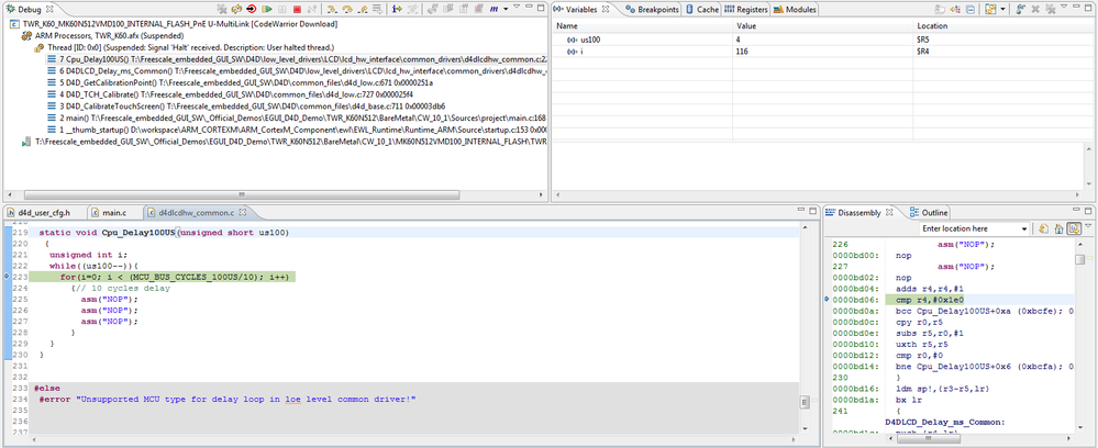

SeanMichael
So I ran it, and left it run, when I pause the program.  It is usually in this set of For Loops.  51-stuckin.PNGIts in a loop in the d4dlcdhw_common.c
static void Cpu_Delay100US(unsigned short us100)
    unsigned int i;
    while((us100--)){
      for(i=0; i < (MCU_BUS_CYCLES_100US/10); i++)
        {// 10 cycles delay
          asm("NOP");
          asm("NOP");
          asm("NOP");
So yea... Where exactly do you guys think I should go from here?  Is there an even more basic way to get the TWR-LCD and K60 to communicate?

Display is working as you can run the demo stand alone. You can program and debug the eGui bare metal project. When you pause the app, where is the code?
Are you sure the TWR-LCD is well plugged into TWR-ELV? And TWR-K60 primary into primary connector?

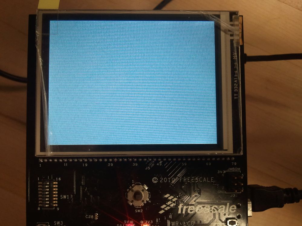

Unfortunately I got that same results.  A White Screen.  As soon as I power the TWR-LCD, I always have a white screen.  I can put it into Bootloader mode, and put the Standalone Demo back on, but I have to keep SW1 as 01000010.  As soon as I switch from that, the screen turns white.

Well that seems to be a one time error.  I have been running the program in the debugger.  But my screen is still white.  I do not get anything at all to show up on my screen.

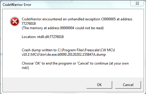

SeanMichael
So I was stepping through the project, and this error came up.  53-CWError.PNG
I have no Idea if this is the cause of my problems, or just a rare occurrence.  Either way, hopefully it's helpful to you guys.

SeanMichael
Ok I have to be missing something.  So this is what I just did.
1. I downloaded the JM128_BL_TWR_I2c.s19, that you linked in http://www.towergeeks.org/forum/topics/twrk60n512-and-tft.
2. I unplugged the TWR-LCD from the TWR-LCD.
3. I put SW1 to ( 1-Off, 2-On, 3-Off, 4-Off,5-Off,6-Off,7-On,8-Off)
4. Put the TWR-LCD into Bootloader mode, by holding SW3 and pressing SW4 while i had the usb attached to the computer.
5. I then unplugged the TWR-LCD and put SW1 to (1-On,2-Off,3-On,4-Off,5-On,6-Off,7-On,8-Off)  and verified that all of SW5 was on.
6. I downloaded the eGui from www.freescale.com/eGUI right into my T Drive, where I extracted it into it's own folder on the T Drive.
7.  I plugged the TWR-LCD into the Primary TWR-ELEV. which already had the K60 and the TWR-SER plugged into it.
8. On the underside of my K60 it has both of these stickers, 700-26548 REV B, and SCH-26548 REV D. Which I am assuming that the Schematic Rev is the one that I am checking to make sure is Rev. D.
9. I on the top of my board, I made sure that J16 was not jumpered.
10.  First when I opened CW10.1, I made a new workspace on my T Drive. Then immediately did a reset perspectives.  Afterwards I did a file/Import/Existing Files into Workplace => Then searched for T:/Freescale_embedded_GUI_SW/_Official_Demos/EGUI_D4D_Demo/TWR_K60N512/BareMetal/CW_10_1 and hit OK.  made sure that the check box was checked, and hit finish.
11.  Opened up d4d_user_cfg.h in Sources/project/D4D_Configuration and this is what I have now.
Line 89:      //#define D4D_LLD_LCD_HW d4dlcdhw_kinetis_spi
Line 90:      #define D4D_LLD_LCD_HW d4dlcdhw_flexbus_16b
12. I then hit build, which everything compiled.
13. I then switched from Internal RAM to Internal Flash, then re built the project.
13.  I plugged my first usb cable into J5 on the Primary TWR-ELEV.
14. I plugged my second usb cable into J13 on the TWR-K60N512
15.  I then hit Debug, which I choose TWR_K60_MK60N512VD100_INTERNAL_FLASH_PnE U-MultiLink, click OK and wait until the Resume Button at the top of the Debug window becomes available to click.
16. Click Resume, and my TWR_LCD continues to stay White.  Nothing ever changes on there....  No noise, nothing.
17. I went back and tried to reverse the two define lines, to make sure that I didn't misread what was written in the other thread.   I commented out the Flexbus line, and uncommented the Spi line, which they now look like the follow.
Line 89:      #define D4D_LLD_LCD_HW d4dlcdhw_kinetis_spi
Line 90:      //#define D4D_LLD_LCD_HW d4dlcdhw_flexbus_16b
18. I build the project again, then I hit debug and wait for the Resume Button to become available to click again.  Which gives me the same exact result.
55-IMG_20120202_135126.jpghttps://community.nxp.com/discussions/57-IMG_20120201_163729.jpg" target="_self
So guys... Am I doing something wrong?  I am completely stumped....

The error should be removed doing a clean of the project. I have tested the eGUI package projects and your projects. BSPCFG_ENABLE_TCHSRES    1 is needed to get the touchscreen working on MQX + eGUI.
Try the eGUI bare metal example to check if there is a problem in the TWR-LCD settings. You can find here instructions:

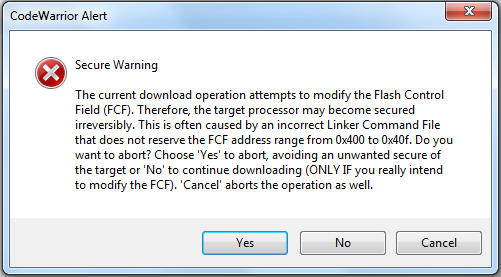

That is warning message is not a real issue. That have been changed  in CW10.2. It is a warning about Flash Configuration register that has been modified. Pressing no will flash the app. Is any app running? Do you have the right user_config.h bsp configuration?

Well sorry for being a pain yet again, but the program advances, to this box
Where I click on "No", to continue downloading the program.  Which then nothing happens.  It gets stuck like the follow.
And then that is the extent of it.  I am using the BSP file from Freescale MQX 3.7/mqx/build/cw10/bsp_k60n512.   The project I am using, is the one you just sent me, I have a copy of the original folder, but in the original folder, where I am running the program from.  Freescale_embedded_GUI_SW/_Official_Demos/EGUI_D4D_Demo/TWR_K60N512    I deleted the original MQX_3_7 folder, and replaced it with the one you sent me.  I did a clean project once I imported the file, because I got a make *** target error.  It was looking for the main.c file in D:/working/......   On my computer, there isn't a D drive at all.  Once I did that, it compiled, and got to the two screens I sent you.   The entire time I wrote this message, I let it continue to run, and it hasn't moved at all.

anthony_huereca
Starting with the Quick Start Demo was the best way to make sure your setup is working.
The error you're seeing is likely due to that the project is looking for the memory configuration file in MQX that is at the default location.
Go to Run->Debug Configurations from the menu bar.
Then select the the CW_10_1_twrk60n512_Int_Flash_Debug_PnE OSJTAG (or whichever you're using) configuration.
On the screen, there is a box that says "Remote System", and it has a drop down box selection. Click on the "Edit..." button next to that box.
In the dialog box that pops up, click on the "System" tab
Then there are two text boxes specifying the "Initialize target" and "Memory configuration". Edit the paths in those boxes to match where you installed MQX.
Then you should be able to download your code!
