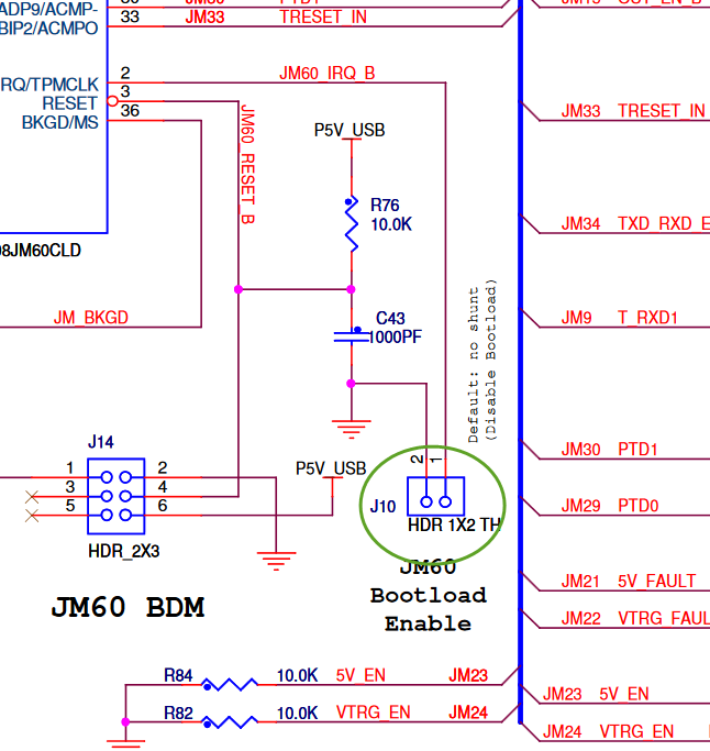

I have kit TWR-K60N512 Rev. D and I want to use IAR Embedded Workbench IDE.
I installed drivers (PEMicro USB Serial Port, WinDriver, Open Source BDM-Debug Port).
When I download a program I confirm
"Old OSJTAG/OSBDM firmware has been detected. The embedded firmware needs to be in bootloader mode to update. Please unplug the USB cable, insert a jumper on the 2-pin bootloader header (connecting JM60 IRQ to ground), and reconnect the USB cable."
While using Firmware Update and Architecture Selection Utility (PE micro) and again ends Confirm  "...... the 2-pin bootloader header (connecting JM60 IRQ to ground) ......."
According to the scheme must be shorted header J10, but for such a kit is not. I believe that this is the J12, but even after shorting to get away. Please ask me.

kerryzhou
Hi Jiri Kral,
     In TWR-K60DN512 REV D, you should also use J10, not J12, J10 is the bootloader enable interface.
   Please refer to this schematic:
http://cache.nxp.com/files/32bit/hardware_tools/schematics/TWR-K60N512-SCH_D.pdf?fpsp=1&WT_TYPE=Sche...
Please follow the notification, do the according operation in J10.
