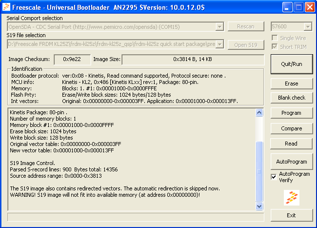

Now, the new situation is wrong traffic in "ident" command.
In KL25Z, the ident response should be:
            (Version), 0x88
            (SDID-H), 0x14
            (SDID-L), 0x86
            (bootloaderIdent)
            00 00 00 01 00 00 10 00 00 00 ff ff 00 00 10 00 00 00 00 00 00 00 04 00 00 00 00 80 4b 4c 32 00 00
And these byte arrays are verified in memory window. And I double verified it in uart_putchar(). However the real receiver on PC gets following traffic:
            Traffic:
            00 00 00 00 00 00 00 00 00 FC FC FC
            88 14 86
            80 80 80 01 80 80 10 80 80 80 FF FF 80 80 10 80 80 80 80 80 80 80 04 80 80 80 80 80 4B 4C 32 80 80
Then I enforeced to send bootloaderIdent in constant byte arrays, instead of structure def. But I got same result. It seems that UART_putchar are trimmed in a wrong timing?

There is a bug in the KL25Z silicon around UART baud, not sure if this is what you are seeing.
The problem depends on the clock path, see
Be Aware of the Baud Problem | MCU on Eclipse
5,105 Views
kai_liu
Senior Contributor I
Well, that is an useful information. Thanks!
Currently I slow-down its baudrate, so I got it working on 57600bps. Amazing.
I have updated and summary my discussion thread. It seems most of things are correct, unless we use in wrong way with wrong options.
Since FSL doesn't offer off-the-shelf demo for A2295, I am working on one with modified linker icf file.
5,104 Views
