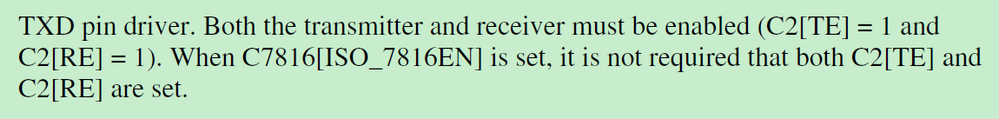

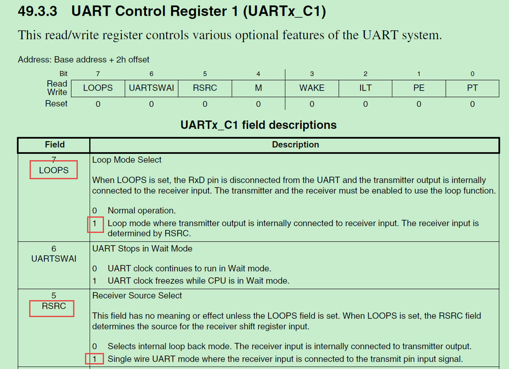

For pin No. 15, 16 and 17 only with ADC function, there is no way to using software UART with those pins.
For K22 UART  supports Single-wire operation mode, the UART TX could be used as UART transmit and receive pin in a half-duplex working mode.
Please check below picture for the detailed info:
Wish it helps.
