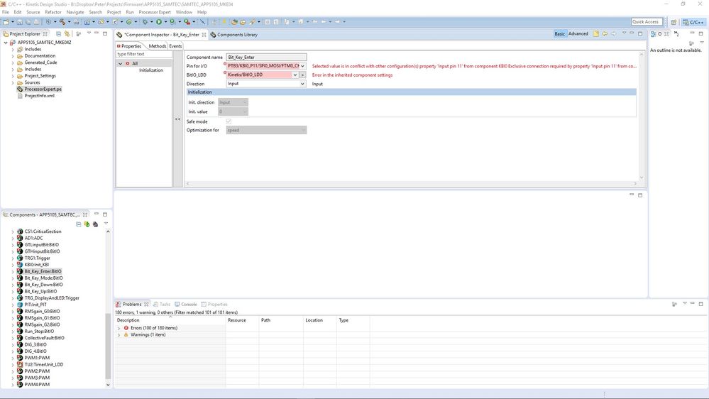

Hello I am porting my application from MKE02 to MKE04. The development  platform is KDS with Processor Expert. The problem  I met is with the KBI. What  I did on the MKE02 was defining  my key interrupts on the KBI and also on the same pins set BitIO’s so I can poll for double key presses etc. If I want to do the same strategy on the MKE04 I get the Processor Expert error “Selected value is in conflict with other configuration property”. This was not the case on the MKE02. What to do? (The Input is configured for KBI interrupt as well as input).

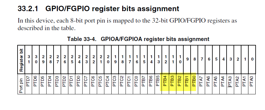

   Actually, if you just want to to read the PTB0... PTB3 input data.
  You can read the register directly.
GPIOA_PIDR |= (1<<8) | (1<<9) | (1<<10) | (1<<11); // enable the input function
Then you can read GPIOA_PDIR data,and check bit8-bit11, it is the PTB0-PTB3 data.

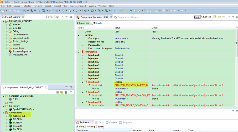

kerryzhou
Hi Ad van Gorp,
  I have checked your attached project.
   I know what's going on.
  You can't select the same pin in the different module in the PE component, otherwise, it will report the conflict problems.
  1. You KBI0 choose the PTB0
2. BitIO module, you choose the PTB0 again
So, you meet the problems.
 If you want to use PTB0 as KBI0 pin, please don't configure other module eg BitIO to PTB0 again.
 If you want to get the PTB0 GPIO input status, you totally can use the register control code in the project directly, you don't need to configure the PE module.
Wish it helps you!
Kerry

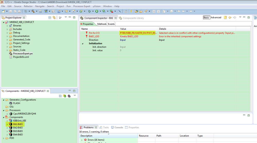

Hello Kerry, thank you for the fast response. Below the screenshots you asked for the first seen from the KBI component and the second one from the BitIO.
The problem is on pins PTB0,PTB1,PTB2 and PTB3 as I use the QFP 64-pin package the pin numbers are 34, 33, 32 and 31.
As asked for I created a new project with the MKE04z processor and imported the Processor Expert settings from the
MKE02 project, this gave the error also.
Then I deleted all imported components and created a new KBI and BitIO component on the same input pin which did not solve the problem.
Please advise, Thank you, Ad
