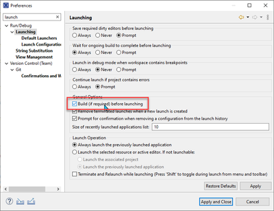

Apparently my auto-build setting in tripleDemod_Debug_Segger doesn't build the project. I have to do that manually, then debugging works fine.

I'm usually not using that feature, but I checked it on my side: it works as expected.
What I'm using otherwise is the global setting here:
Are you sure you used the correct launch configuration?

I modify the file either in Kinetis or my editor, save and press debug with auto build.
I have to "Build Project" to get compiled.

Are you sure you have not modified your source files after having them compiled?
