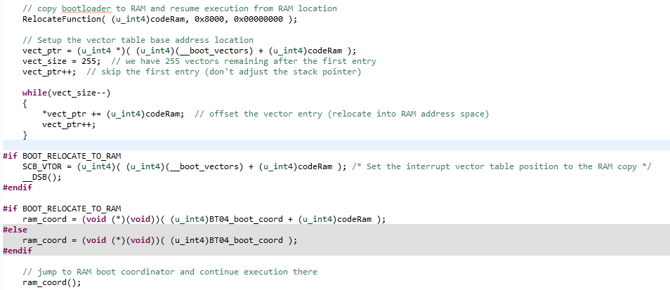

scottthompson
I have written a bootloader but also rely on interrupts for UART, etc.
What might seem confusing is that the actual flash command processing must occur in SRAM (e.g., FlashCommandSequence), but separately if you are going to overwrite your ROM vector table, it has to get relocated to SRAM as well.
For my bootloader, if I'm going to flash sections like my boot config tables, I have to ensure that all of this is running in SRAM as well.  I use scatter loading and have a dedicated region in SRAM to hold a copy of my main bootloader application.  I copy all of my flash memory over to the SRAM location and adjust the SRAM copy of the vector table to be offset by the SRAM base (see below).
Once you relocate your code and change VTOR to point to the newly updated vector table, you can "jump" to the bootloader in SRAM and re-enable interrupts.  Your UART ISR, etc. will get called from your relocated copy in SRAM.

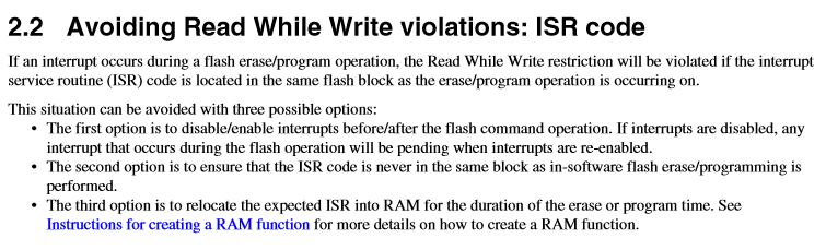

mjbcswitzerland
Specialist V
Flash will be written by code operating in SRAM. If there are interrupts in the system they should also be blocked.
This is made clear by AN4695:
Note that AN2295 doesn't look to be using interrupts so it can't be takes as a general reference.
"Unable to retrieve disassembly data from backend" I believe that this may occur when trying to debug in SRAM based code when the debugger can't relate the disassembled code to any source code. You should still be able to step the code in disassemble mode and ignore such error messages. Alternativey, just run across the routine in SRAM.

mjbcswitzerland
Specialist V
When writing or erasing Flash the Flash is not available for running code from. This is also true when the code is executed due to interrupts. Therefore, if the interrupts are not run in RAM or their code cannot be located in an alternative Flash block that is still free, interrupts MUST be disabled to avoid a failure due to the interrupt trying to use the unavailable Flash to run from.
