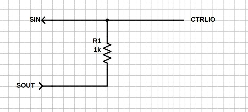

myke_predko
Senior Contributor III
Hi @marcelabuena
Can I ask that the first thing you do is lose the "MISO"/"MOSI" terminology and stick with the "SOUT"/"SIN" labels used on the chip.  I know it was part of the original specification and continues in Arduino but it can be confusing - especially in this instance.
The simplest way of doing it is to start with the SIN pin connected directly to the controller's IO pin and then add the SOUT pin through a current limiting resistor (I would start with 1k):
That's it - when the controller is sending instructions, anything output on SOUT is overridden and when the controller is receiving data, SOUT becomes the dominant driver.
You may need to play with the resistor value depending on your controller IO drive capabilities.
Regardless, a very simple and fast way to use a single wire with an input and output pin. Easy peasy.
myke

mjbcswitzerland
Specialist V
The SOUT pin can also be configured as open drain output. If there is a decent pull-up on the (connected) SIN line it will allow high speed bi-directional SPI - send 0xff when receiving.
