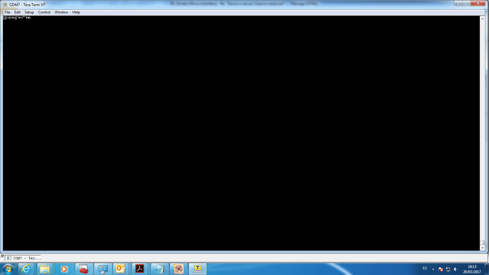

I´m new with freescale microcontrollers and I am testing a board with MK20DX256VLH7 microcontroller. I have startedwith a Project developed with the Processor Expert tool. In order to develop the application I have followed step by step "the Processor Expert Software – Microcontrollers Driver Suite Getting Started Guide" tutorial. Then when I had to test debugging I saw that the LED was flashing well with the correct frequency, but I checked that the message sent to Tera Term Application by UART wasn't correct. Tera Term has received something but there are some strange characters. The string that I send is "Hello World". The direction where is stored the string is 0xfc0 allways, although I change the string, and I saw that all characters are stored in them.

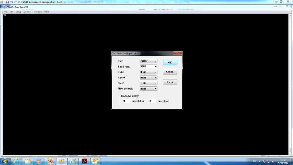

The configuration is the same in Tera and in AS1 component, the baud rate is 9600, no parity, stop bit, 8 bits, and no control flow.

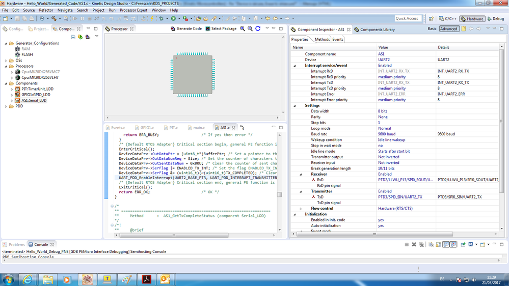

When I execute step by step inside the "AS1_SendBlock" function, I can see how the characters are saved. For example the character that I can see in *DeviceDataPrv->OutDataPtr is 0x48h, that is the hexadecimal character of first letter "H". Then later it is executed the next line:
UART_PDD_EnableInterrupt(UART2_BASE_PTR, UART_PDD_INTERRUPT_TRANSMITTER);
Here I think it´s the sending order. Why don´t send the string correctly? There are something in the configuration? The configuration should be different with MK20DX256VLH7? The baud rate is ok?
In my application “AS1_SendBlock” function  is executed step by step like it should be, but when I want to see where the data are sent (in which output registers) when the transmission interrupt is enable, I don’t know where because they are unknown for me. Do you Know the registers in which appears the UART output transmission data or the UART output buffer for mK20dx256vlh7 microcontroller?? I´m reading in the datasheet and I don´t find any registers related on them. I want to see if the transmission data in these registers are the same that I want to transmit and also in order to compare with data that arrive to Tera application.

Finally yestarday I managed to send some chars. Moreover I managed to received “chars” from the PC to microcontroller, and back to re-send from the microcontroller to PC like I was doing “an echo”. I had to use another component different, I’ve used “Asynchro Serial” component. It works fine capturing characters from the PC and re-sending to microcontroller, but also I want to send blocks of characters like words not only individual characters. I saw SendBlocks doesn´t exists in “Asynchro Serial” component, like Serial_LDD but I have problems to receive with Serial_LDD. Do you know a method to send characters´s block in component “Asynchro Serial” like “Serial_LDD” component?
