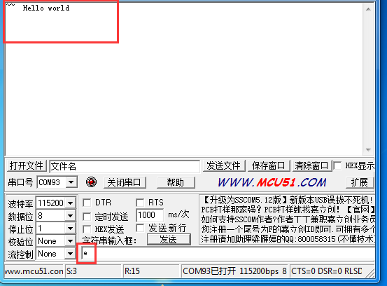

Hello Arturo,
As to there is error when build your project on my side , so I create a new project for you.
I refer to the "Typical Usage" of the component, please check the attachment .
Send a character 'e' on terminal on PC, when k20 board receive it , it will send "Hello world" to terminal .
(Sorry for I haven't a good terminal software of English language , so please ignore the words on my terminal )
Hope it helps
