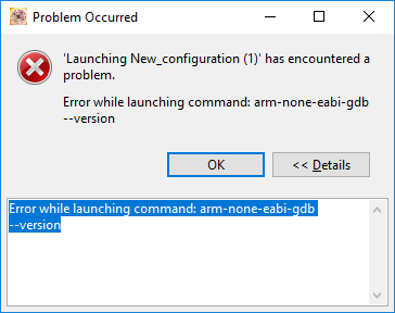

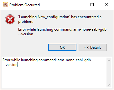

I get this error when I'm using Segger
I selected the segger configuration
arm-none-eabi-gdb
Why doesn't this work?

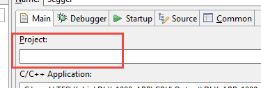

I figured it out:
I had to manually specify the highlighted field

you have the launch config wrong:
You need to specify a project there.

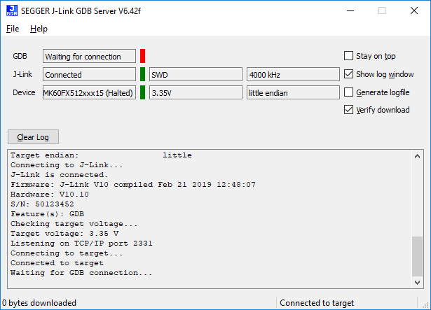

If you already have the GDB server running locally (see Command Line Programming and Debugging with GDB | MCU on Eclipse ), then you shall not launch yet another copy, so uncheck this:

amuresan
I did. Still same issue.

BlackNight
Do not start the J-Link Server exectuable externally. Let the debugger launch it (unless you know exactly what you are doing).

amuresan
If I don't start it externally and I uncheck that box, how is the server launched?

BlackNight
It starts the server locally (as indicated in the checkbox).
