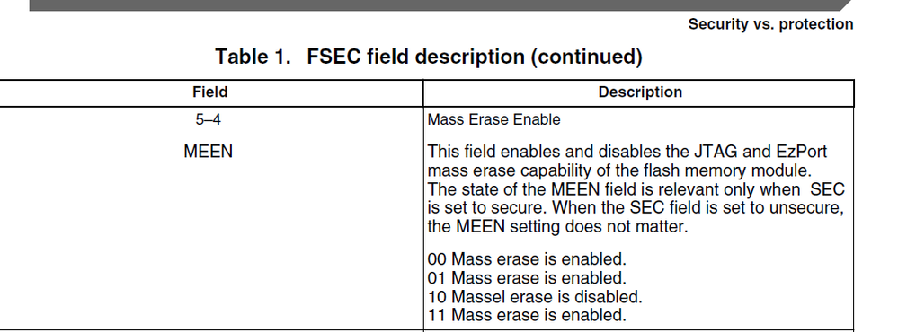

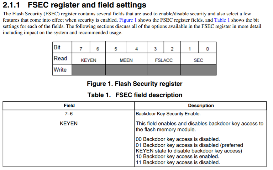

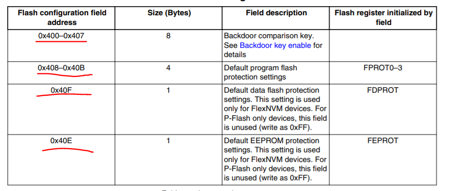

  2. should the JTag header be physically disabled or can firmware do this permanently?
    Yes, Just disable the mass erase enable bit in flash address 0x40c bit4.5.
  You can refer to this application note:
https://www.nxp.com/files-static/microcontrollers/doc/app_note/AN4507.pdf
page 3
Don't worry, this bit just influence the SWD JTAG and EZport mass erase, the kinetisflash tool still can erase the chip with backdoor key.
You can try it on your side.
Wish it helps you!

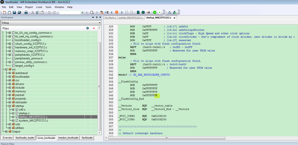

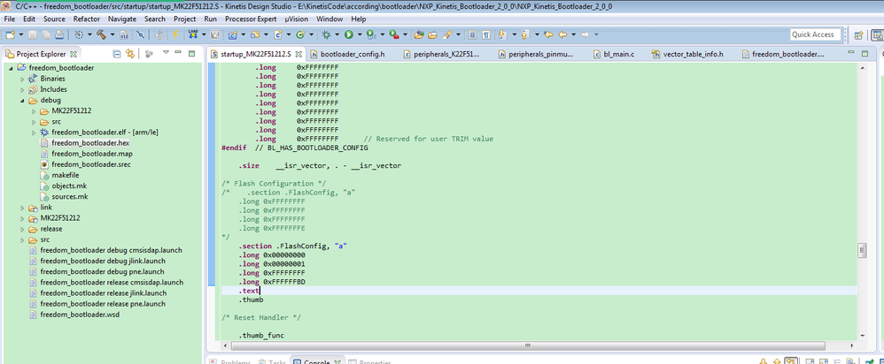

Is there a place within the tower_bootloader code for the K22FN256 where I can set the FSEC register as well as the backdoor key values?
11,129 Views
kerryzhou
Hello Christopher,
   Of course, you can!
   Please check my following picture:
FlashConfig used to configure the flash configuration field.
Wish it helps you!
Kerry

burgeh
Is that just setting the FSEC register? Where I do I enter the backdoor key value, and enable backdoor key?
11,128 Views
kerryzhou

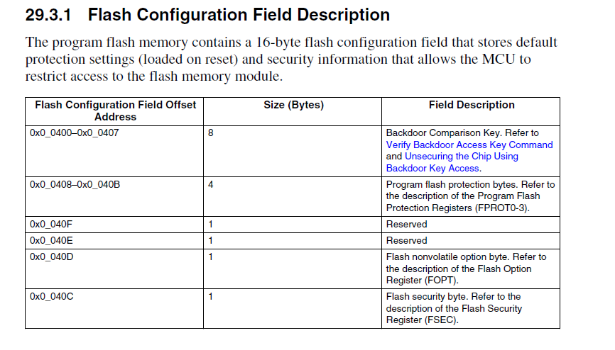

Please refer to the user manual,the flash configuration field is the 16byte space, it is the same as the code __FlashConfig , if you want to modify the backdoor key, just modify the front 8bytes in __FlashConfig.
Kerry

mjbcswitzerland
Specialist V
Christopher
__FlashConfig
DCD 0xffffffff <- backdoor keys1
DCD 0xffffffff <- backdoor keys2
DCD 0xffffffff <- program protection
DCD 0xfffffffe <- (data flash protection / EEPROM protection / non-volatile options / security setting)
but I don't know why it is done in assembler since it is rather cryptic.
In the uTasker loader it is done as follows, which is more use friendly:
const KINETIS_FLASH_CONFIGURATION __flash_config
    KINETIS_FLASH_CONFIGURATION_BACKDOOR_KEY,
    KINETIS_FLASH_CONFIGURATION_PROGRAM_PROTECTION,
    KINETIS_FLASH_CONFIGURATION_SECURITY,
    KINETIS_FLASH_CONFIGURATION_NONVOL_OPTION,
    KINETIS_FLASH_CONFIGURATION_EEPROM_PROT,
    KINETIS_FLASH_CONFIGURATION_DATAFLASH_PROT
// FLASH configuration settings (these are plugged into the KINETIS_FLASH_CONFIGURATION_BACKDOOR_KEY area)
#define BACKDOOR_KEY_0     0x00       // note that values with all 0x00 or all 0xff are not valid
#define BACKDOOR_KEY_1     0x00
#define BACKDOOR_KEY_2     0x00
#define BACKDOOR_KEY_3     0x00
#define BACKDOOR_KEY_4     0x00
#define BACKDOOR_KEY_5     0x00
#define BACKDOOR_KEY_6     0x00
#define BACKDOOR_KEY_7     0x01
#define KINETIS_FLASH_CONFIGURATION_SECURITY           (FTFL_FSEC_SEC_SECURE | FTFL_FSEC_FSLACC_GRANTED | FTFL_FSEC_MEEN_ENABLED | FTFL_FSEC_KEYEN_ENABLED)
#define KINETIS_FLASH_CONFIGURATION_PROGRAM_PROTECTION (0xffffffff)  // PROT[31:24]:PROT[23:16]:PROT[15:8]:PROT[7:0] - no protection when all are '1'
#define KINETIS_FLASH_CONFIGURATION_NONVOL_OPTION      (FTFL_FOPT_EZPORT_ENABLED | FTFL_FOPT_LPBOOT_NORMAL | FTFL_FOPT_NMI_DISABLED)
#define KINETIS_FLASH_CONFIGURATION_EEPROM_PROT        0xff
#define KINETIS_FLASH_CONFIGURATION_DATAFLASH_PROT     0xff
A possible secure setting for your case is thus 0xbc
Mark

burgeh
I have these values set, so this would set the FSEC to secure, and set the backdoor key to 000...001. However, I still get Unsecure from KBOOT as well as I can erase easily from J-Link Commander.
kerryzhou‌ I seem to have it set correctly. I am using the tower_bootloader code on the K22FN256. Not quite sure why it would not be securing. I've built it a few times as the release version. Any other place I need to change? I attached my current tower_bootloader. I don't recall any changes other than the flashconfig.
11,126 Views

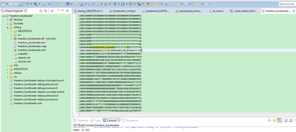

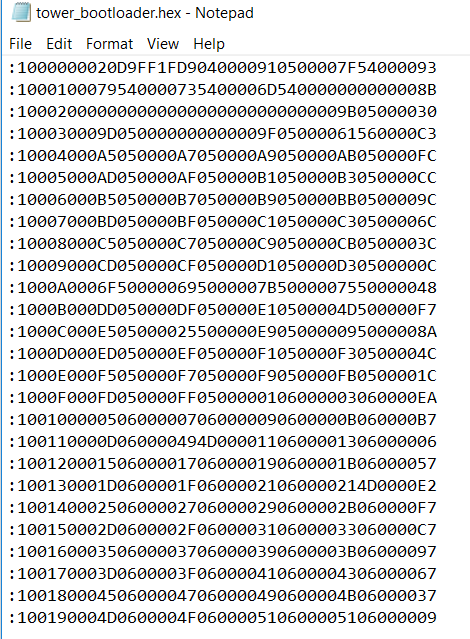

kerryzhou
Hi Christopher,
     Don't worry, please generate the .hex file, and in the hex file, check the according flash address, whether the data is configured as your defined? If yes, it is correct.
   Besides, when you use the JLINK, as you know, there will have a chip partnumber select, you need to select the partnumber with allow security, that means when you use the JLINK, the flash configuration field can be modified, otherwise JLINK won't update the flash configuration field.
    Please also note, even your secure the SWD, but you still can use the SWD to unlock it, if you enable the mass erase bit. this is correct. But others can't read or write directly through the SWD if it is unlocked, unlock is just the mass erase.
Wish it helps you!
Kerry

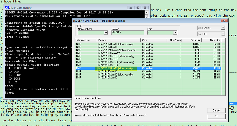

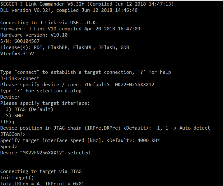

burgeh
What do you mean by this exactly? When I use J-Link commander below is an image of my typical settings, is there something I'm missing?
How can I confirm this? This image tells me the address, but I do not see where this is.
11,126 Views
kerryzhou
Hi Christopher,
   Your selection is not correct, please check my side:
You can find two items, one is allow security, another won't allow security, this is the JLINK driver. If you don't select the allow security, even you secure the chip, when you download the code, the JLINK debugger will still won't modify the flash configuration field.
  So, please select the chip as MK22FN256xxx12(allow security), then try it again.
  About your hex, your picture still not in the 0X400 side, it is just contains 0x40 address. You can share me your whole .hex file.
  Please note, in the IDE JLINK inteface, you also need to select the chip as MK22FN256xxx12(allow security), this is very important.
Kerry
11,126 Views

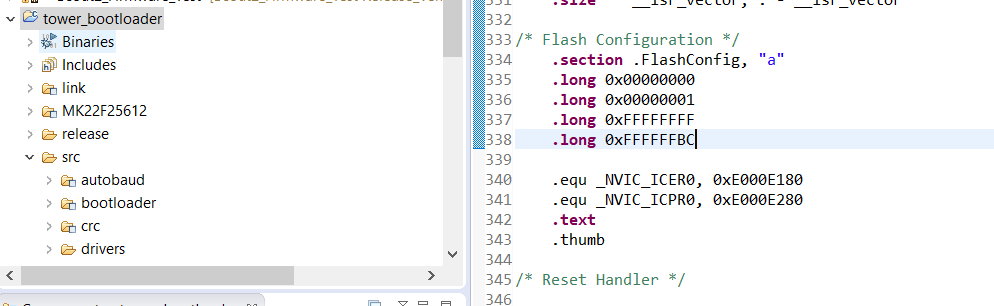

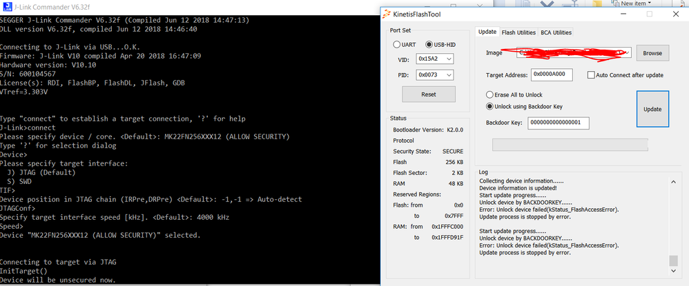

burgeh

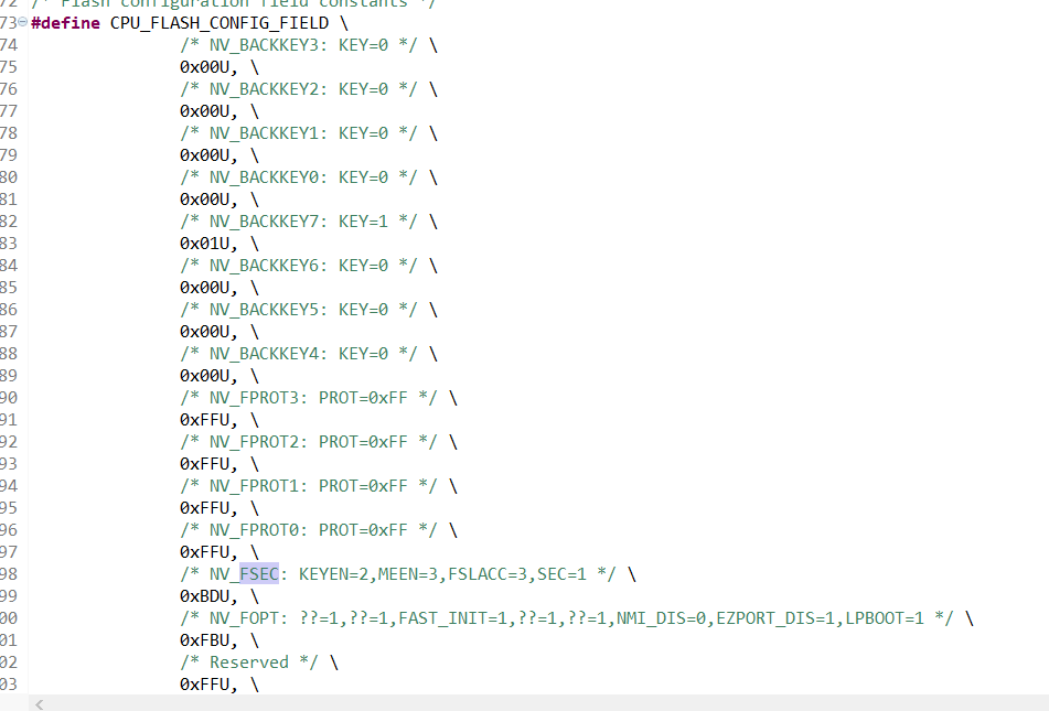

Perfect, I was unaware of that setting with the J-Link. Almost there! The image below shows my attempt at flashing. As you can see the chip is now secure, however, I am having an issue with the backdoor key. I believe it is enabled, I have my flash config in the second image below, and according the image 3 it should be enable. Also I do not wish to disable the mass erase, to clarify, I want to not allow others to mass erase without the backdoor key.
Image 1. Successful FSEC setting, but not Backdoor Key
Image 2. Code used I believe to set FSEC and KEYEN. "0xBD" is 10 11 11 01 to enable FSEC and KEYEN
Thanks!
11,126 Views
kerryzhou
Hi Christopher Burg,
    You are near the success, but you have a mistake.
  Please check my operation:
1. add the backdoor key in the bootloader, and secure the chip.
Please note, the back door key is:0000000001000000
You also can find it in the .hex file:
You are using the wrong backdoor key, I am using the uart port to update the app, and test board is the FRDM-K22 board, this is the test result:
You can find, I can download the code with backdoorkey sucessfully.
Please try it again on your side.
Wish it helps you!
Kerry

burgeh
Thanks! I am a little bit confused as to why the backdoor key is 0000 0000 0100 0000 and not 0000 0000 0000 0001? Could you explain a bit more? Because we set the first 8 bytes to 0x0000000000000001. I confirmed that I can flash it now with the key you told me. I also saw how it is set in the hex file thanks!
11,125 Views
kerryzhou
Hi Christopher,
  Good, from your picture, you also make it works, now answer your new two questions:
1.why the backdoor key is 0000 0000 0100 0000 and not 0000 0000 0000 0001?
    .section .FlashConfig, "a"
    .long 0x00000000
    .long 0x00000001
    .long 0xFFFFFFFF
    .long 0xFFFFFFBD
Please note:
.long is the LE, not BE. LE means little end, BE means Big end.
So, 0X00000001, 0x01 is the address 0x404.
    .long 0xB3B2B1B0
    .long 0xB7B6B5B4
In the backdoor key is:B0B1B2B3B4B5B6B7
I think this is good to understand now.
2. jlink commander
 Yes, don't use JLINK command to connect it again, it will unlock it automatically.
Please note, secure but allow the mass erase, other people can't erase it, but can't read or write the code, so it will protect the code from accessing through the SWD interface. Erase won't be protected.
