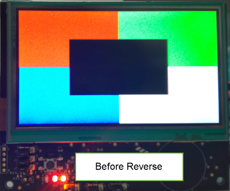

I do a test with TWR-K70F120M board with TWR-LCD-RGB board.
The TWR-LCD-RGB LCD screen size is 480 X 272. The frame start address at 0x80400000, the frame buffer size is 0x7F800.
The original LCD display shows at below picture, the red color at top left corner (LCDC_LSSAR register value is 0x80400000):

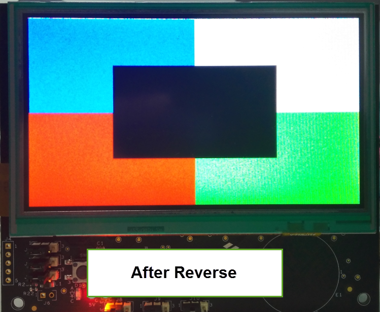

While after I set the LCDC_LPCR [REV_VS] bit and change LCDC_LSSAR register value to 0x8047F800, there make a horizontal mirror reverse.
After vertical scan reverse, please check below picture of the LCD display, the red color block at left bottom corner:
My test code if from Kinetis 120MHz bare metal sample code LCDC demo, which could be downloaded from here.
Wish it helps
