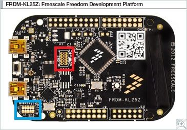

harshbhatt
Should it be through the SDA SWD or the other SWD? See the attached image. Red SWD or blue SWD?FRDM-KL25Z_BDTN.jpg
6,603 Views
kerryzhou
Hi Harsh Bhatt,
    If you want to use the JLINK, you should use the RED SWD, this is used for the KL25 chip.
    The blue one is the SWD to K20 which used for the opensda Debugger.
Jingjing
6,603 Views
harshbhatt
Understood, but the mass erase - that should be on the KL25 chip only? not the opensda chip?
6,603 Views
kerryzhou
Yes, mass earse is to KL25 chip.
You don't need to mass erase the opensda chip, the opensda chip already have the bootloader code in it, you's best don't earse it, if you want to use the different debugger in the opensda chip, just change the firmware which you can download from pemicro or segger website.
