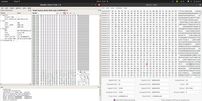

ktbalazs
I think, the linker script can influence this, too.
What do you think?
This is my modifications: (commented are the originals)
/* Specify the memory areas */
MEMORY
m_interrupts (RX) : ORIGIN = 0x00000000, LENGTH = 0x00000400
m_flash_config (RX) : ORIGIN = 0x00000400, LENGTH = 0x00000010
m_text (RX) : ORIGIN = 0x00000410, LENGTH = 0x0003FBF0
m_data (RW) : ORIGIN = 0x1FFFC000, LENGTH = 0x00006000
m_data_2 (RW) : ORIGIN = 0x20002000, LENGTH = 0x00008000
//m_data (RW) : ORIGIN = 0x1FFFC000, LENGTH = 0x00004000
//m_data_2 (RW) : ORIGIN = 0x20000000, LENGTH = 0x00008000
The left is the hex what I read back, the right is what I flash.

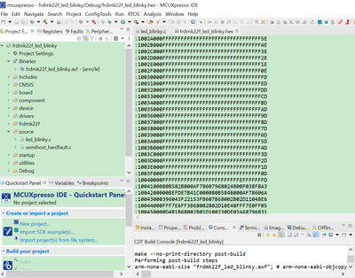

kerryzhou
Hi @ktbalazs ,
 From your right side which should be the original code, it is totally wrong, as the original app 0X40C is the special area.
  This is the mcuxpresso IDE generated .hex.
In my memory, the KDS generate .hex should be the .s19 in default, so you may try to modify the .hex to .s19. Then open it again, whether the 0X400 is all 0XFF except the 0X40C is 0XFE.
So, I recommend you use the MCUXPresso IDE with the newest SDK.
As even the KDS IDE have bugs, it won't be fixed, MCUXpresso is used to replace the KDS for the kinetis, thanks.
Wish it helps you!
Kerry
