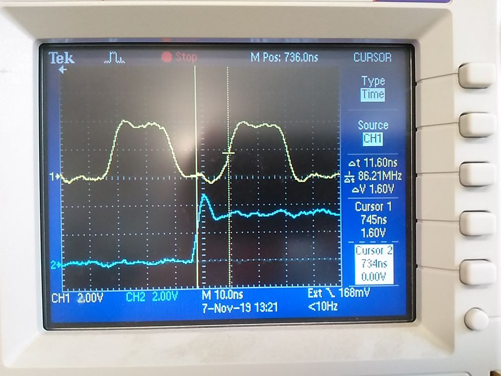

My 25MHz SPI master application (CPOL=0,CPHA=0) is seeing occasional errors in the received data from the slave.
MISO data from the slave to the MKS22 only has ~10ns setup time to the rising clock edge which is less than the specified 16ns required.
Simple solution would seem to be to enable Modified Transfer Format to delay the MKS22 sample of SIN by Tsys.
Setting the MTFE bit in MCR however breaks communication completely.
We're using two 16 bit transfers per transaction and using the CONT flag to make 32 bits per CS.
With MTFE set we get two 17 bit transfers!!
This is the only code change:
// SPI0_MCR = SPI_MCR_MSTR_MASK | SPI_MCR_PCSIS(0b11111) | SPI_MCR_CLR_TXF_MASK | SPI_MCR_CLR_RXF_MASK | SPI_MCR_HALT_MASK;
SPI0_MCR = SPI_MCR_MSTR_MASK | (1<<26) | SPI_MCR_PCSIS(0b11111) | SPI_MCR_CLR_TXF_MASK | SPI_MCR_CLR_RXF_MASK | SPI_MCR_HALT_MASK;

chris_f
Contributor V
"What's the SPI slave you are using?"
- It's an Allwinner H5 - can adjust timing as master but not as slave.
"25MHz SPI master application, KS22 occasional errors ... Could you share the detail errors?"
- It's an audio streaming application. We have no way of recording both ends of the stream but have demonstrated that there are data dependant bit errors occurring (approximately 1 in a few million packets) in this interface.
- I suspect the cause of occasional error is setup time (SIN from slave to master -> SCK rising edge)
My understanding from the datasheet was that I could use MTFE mode to delay the MKS22 SIN sample point by one cycle of Tsys (50MHz) or in other words to the next falling edge of SCK.
However, when I set MTFE=1 I get 17 SCK cycles for each write of PUSHR. I didn't expect that!
Below image shows a saved trace (top) with MTFE=0, and a trace with MTFE=1. In both cases there are two writes to PUSHR and FMSZ=15.

chris_f
Contributor V
I've added a parity bit to the spi communication and confirmed the error rate at around 1 bit error per 500k transactions without MTFE.
There are two slaves on the bus. I can reduce the error rate a lot (not sure if it's eliminated completely) by removing one of the slaves. This seems to confirm (?) lack of setup time as the problem.
Can someone confirm that MTFE mode is functional in these devices?

chris_f
Contributor V
The number of bits in a transfer is determined by CTARx -> FMSZ where number of bits = FMSZ+1.
With MTFE=0, I get number of bits = FMSZ+1.
With MTFE=1, I get number of bits = FMSZ+2.
If you look at the scope image I posted earlier, there are two bursts of 17 SCK cycles. Given the 0<FMSZ<=15, getting 17 SCK cycles shouldn't be possible?

kerryzhou
Hi chris_f,
  Yes, I have checked your wave, when MTFE=1, it really one more cycle than MTFE=0.
  But from the RM, I didn't find any description that MTFE =1 will be need one more SCK.
  What's the fsck relationship with fsys on your side? Can you test these information:
1. MTFE=1, CPHA=0, fsck = fsys/4
2. MTFE=1, CPHA=0, fsck = fsys/2
3. MTFE=1, CPHA=0, fsck = fsys/3
4. MTFE=1, CPHA=1, fsck = fsys/2
Any different result? You can set FMSZ=15.
Kerry

chris_f
Contributor V
System is running at fsck=fsys/2. I get the same effect (extra SCK pulse with MTFE=1) at fsck=fsys/4 but have not tried fsys/3 or CPHA=1.
I have concluded that the MTF mode will not work for my application due to a problem with the eCSPI module. I'm surprised that this behaviour isn't documented elsewhere.
I have worked around the problem using the FLEXIO module to split my communications on to two SPI buses.
It is simple to set up the equivalent of MTF mode using the FLEXIO module in standard datasheet SPI master settings (RM 47.5.3 SPI Master) and setting TIMPOL to 1 (negative timer edge) in the receiving shift register's SHIFTCTL.
Additionally, the SPI0 errors in my application are eliminated by dropping the baud rate from 24MHz to 16MHz (PBR=0x01). This keeps the SCK high period at 20ns and increases the low period to 40ns allowing sufficient setup time on MISO.
