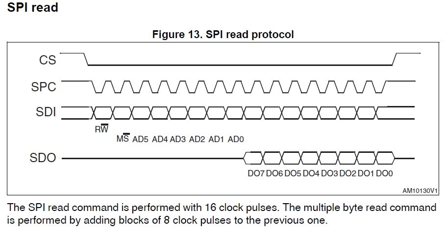

omarvallecasas
Hello Jorge,
Thanks for your quick answer. We tested changing the 4 combinations of phase (CPHA) and polarity (CPOL) settings, and it remained the same issue. The interesting thing is that signal measured at MOSI microcontroler pin (master), is receiving well gyroscope values, but it doesn't appears at UART pin or UART terminal at PC. We really don't know what we're missing. Maybe SPI read protocol timing from Slave would help to realize our problem.
Omar Valle

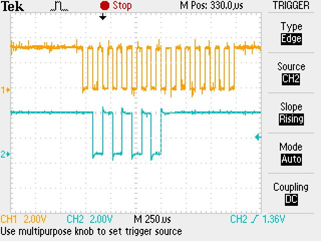

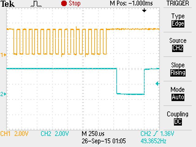

omarvallecasas
Here you have two images to illustrate more. The first is SPI SCLK with SPI MISO, and the second one is SPI SCLK with UART Pin. As you can see, there's no data at UART Pin, different to MISO behaviour.
Thanks really for your time,
Omar Valle

Jorge_Gonzalez
Hello Omar:
Before scanning the UART TX pin it would be better to debug and confirm what is actually received by the SPI module, by reading the SPI data register (e.g. storing the data register in a variable). Watching a signal in the MISO pin does not necessarily mean that SPI transactions are working as expected.
The first screen is only the MISO pin. Can you also show the MOSI pin and Slave Select pin? You can compare the 4 signals you see on the pins (MISO, MOSI, SPSCK, SS) with the expected frame as in the picture you posted above.
Regards!
Jorge Gonzalez

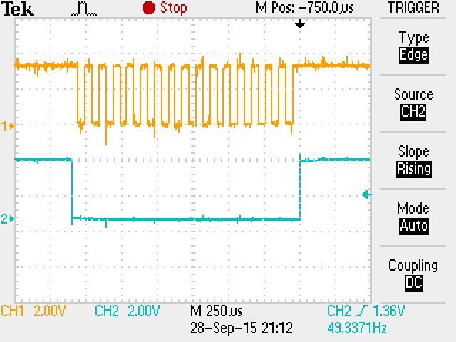

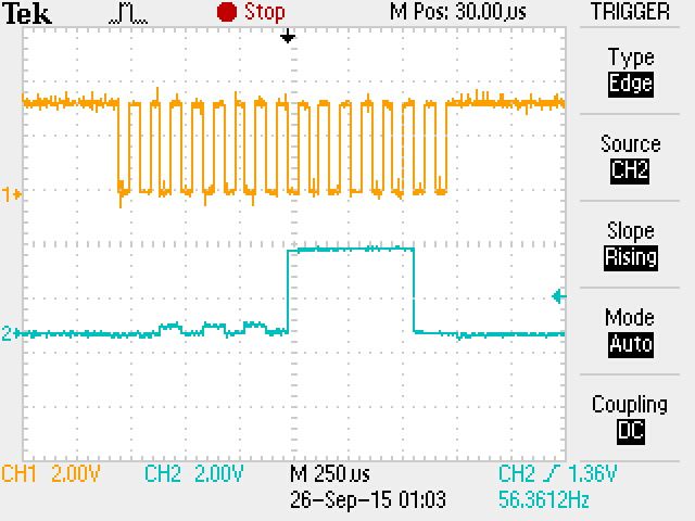

omarvallecasas
Hi Jorge,
Here it is MOSI signal with SCLK (Fig.1), and SS with SCKL (Fig.2). For me it seems fine, maybe you disagree. I already tested store in a variable for later visualization of data, but only appeared 0.
I wait for your comments.
Omar Valle

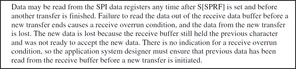

Jorge_Gonzalez
Hello Omar:
Indeed, the signals look correct. I am getting out of ideas but I think this explanation in the Reference Manual might be the cause of your issue:
Try with a dummy read from the data registers (DH:DL) before calling your spi_read() function (or inside the function but before spi_write).
According to the manual new data is lost if you did not read the previous incoming data, which may be why you only see '0'.
Let me know how it goes.
Regards!
Jorge Gonzalez

omarvallecasas
Hello Jorge,
It works!!!!!! Thanks a lot. We were having a overrun issue. Thank you so much. Now, Callibration...
