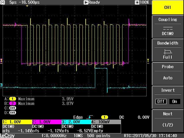

The scope shows the following image:
While the rxData contains 0x12, 0x00 which is clearly wrong. Is there something that I'm missing?

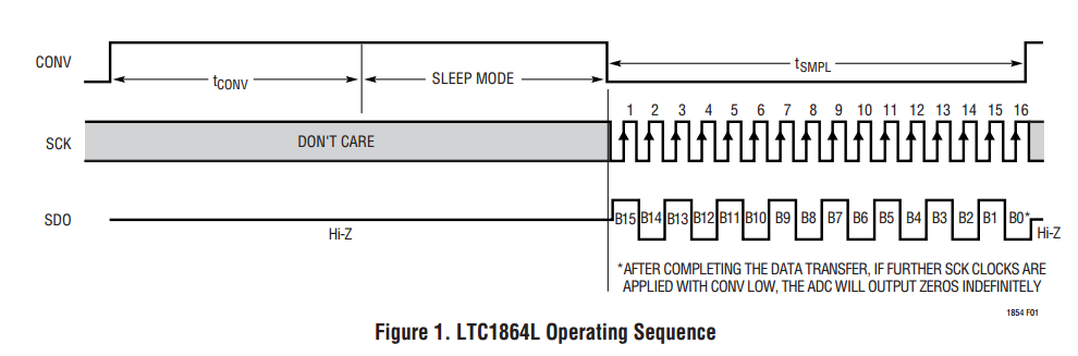

I checked the LTC1864L datasheet, the SPI output data with MSB first:
So, the data you get is 0x0018.
