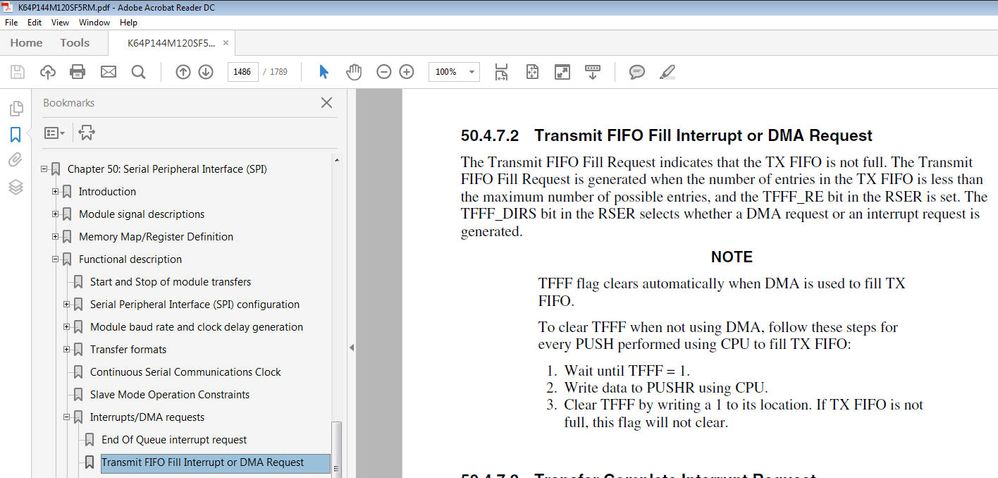

Robin_Shen
Hi Gardner,
You can download the K64P144M120SF5RM first and read the "50.4.2.4 Transmit First In First Out (TX FIFO) buffering mechanism":
Don't write 7 data into PUSHR at a time, the Transmit FIFO size of SPI0 is only 4.
The module ignores attempts to push data to a full TX FIFO, and the state of the TX FIFO does not change and no error condition is indicated.
TFFF flag clears automatically when DMA is used to fill TX FIFO.
To clear TFFF when not using DMA, follow these steps for every PUSH performed using CPU to fill TX FIFO:
  1. Wait until TFFF = 1.
  2. Write data to PUSHR using CPU.
  3. Clear TFFF by writing a 1 to its location. If TX FIFO is not full, this flag will not clear.
The TX FIFO Counter field (TXCTR) in the module Status Register (SR) indicates the number of valid entries in the TX FIFO.

Robin_Shen
Hi Gardner,
I didn't find the reason in the reference manual. It seems a little strange.
I can only find the description in below Note.(just only how to deal with the TFFF)
Best Regard
Robin
