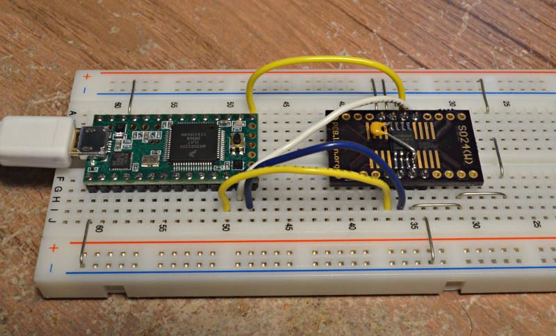

paulstoffregen
I tested a similar SPI flash chip with Teensy 3.1 (Kinetis K20) today, using 12 MHz SPI clock.
It worked fine, even using normal wires on a solderless breadboard.  Details here:
https://forum.pjrc.com/threads/27507-SPIFIO-issues?p=61918#post61918
