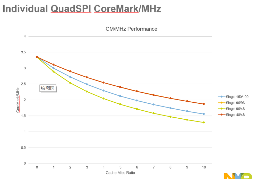

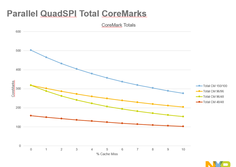

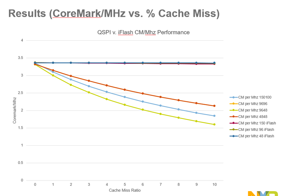

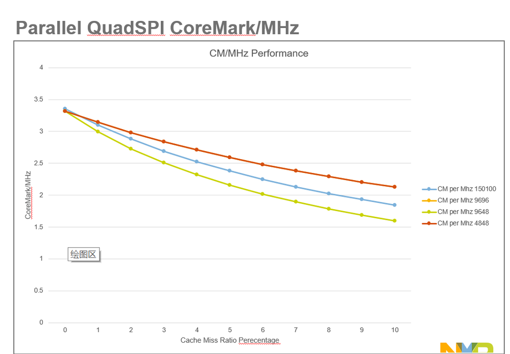

2. Are there any benchmark on performance of external vs internal Flash?
Modified CoreMark benchmark application (added code for cache manipulation and execution time capture)
Force 1%, 2%, 3%....10% cache misses by doing X number of iterations and executing n% with cache disabled and (100-n)% with code cache enabled. X = 4000 for these results.
Cache miss vs. Cache off performance is not equal.  Cache miss adds delay cycle for search and replace.
QuadSPI Configuration
    - System at 1.8V Core VDD and IO VDD
    - IRC48 and 32kHz clock
    - Alias code region
    - Parallel (8-bit) and Individual (4-bit)
    - SDR, 100, 96, and 48 MHz
    - Sys Cache on/off
    - Data mapped to internal > 0x2000_0000 memory space
    - 512-byte Flexible AHB buffer

Here are some questions:     Feel free to answer estimates or typical values below.
1-2) Are my estimates below pretty close (typical) for QSPI vs Internal Flash benchmark speeds? I've used Cypress FL064L as reference.
          QSPI           Internal flash
read: 6-52MB/s ,   40-250MB/s
write: 569KB/s ,    200kB/s
