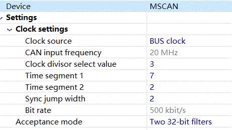

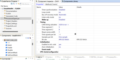

I'm using the SKEAZ64MLH4  for 500kbit/s CAN communication. The configuration sampling point is only up to 80% and the my customer needs a sampling point greater than 85%, Please kindy assist in confirming if there is a feasible configuration?微信图片_20250513102641.gif微信图片_20250513102641.gif

Celeste_Liu
Hello @suntaoisme ,
Thanks for your post.
sample point= (1+TSEG1)/(1+TSEG1+TSEG2), So, according to your configuration, the sample point is calculated as follows:
sample point = (1+ 7) /(1+7+2) = 80%
If you want to achieve a sample point greater than 85%, you need to increase TSEG1. For example, if TSEG1 is increased to 13, the sample point can reach 87.5%.
Hope it can help you.

 thanks for your support, but if only improve Time SEG1, is there some way to  guarantee 500K bit rate?

Thanks for your reply. Would modifying T1 alone be ineffective, and would it provide a solution to validate that it works? Thanks.

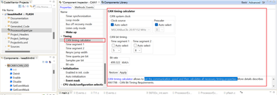

I'm curious about which IDE you used for the configuration page. I'm using Processor Expert in CodeWarrior v11.1 for configuration, and the interface seems different from yours.
Moreover, we have the CAN timing calculator that refers to AN1798(AN1798: CAN Bit Timing Requirements) to set the communication speed and then calculates all the necessary timing parameters.
I think there is no issue with the MSCAN configuration in Processor Expert (PE) of CodeWarrior v11.1. You can use this tool to derive all the appropriate parameters.

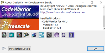

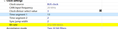

suntaoisme
Hi Celeste Liu,
It's my CW version.
T1=5, T2=8,  sampling point =42% ,and 499.332 Kbit/S is not 500Kbit/S by the customer。
Do you have a better idea of the correct combination of parameters? Thanks.

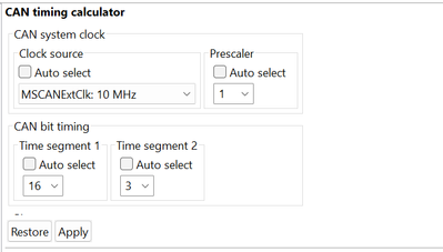

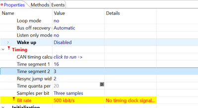

Celeste_Liu
Hello @suntaoisme ,
You can refer to the following configuration, use the external clock with 10MHz, and let TSG1=16, TSG2=3, then the speed can be 500kbit/s and sampling point = 85%.
