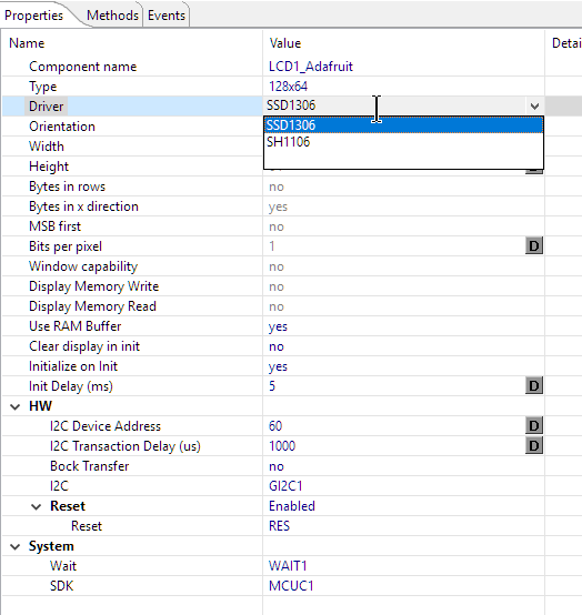

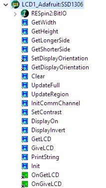

BlackNight
There is a Processor Expert component (SSD1306) for the SH1106 (which is a variant of the SSD1306):
The component is availble on SourceForge (latest release: McuOnEclipse Components: 1-Apr-2018 Release | MCU on Eclipse ). If you want to use the library without Processor Expert: see GitHub - ErichStyger/McuOnEclipseLibrary: Library of McuOnEclipse components .
An example project is availble here: mcuoneclipse/Examples/KDS/FRDM-K64F120M/FRDM-K64F_SSD1306 at master · ErichStyger/mcuoneclipse · Git...
I hope this helps,
Erich
