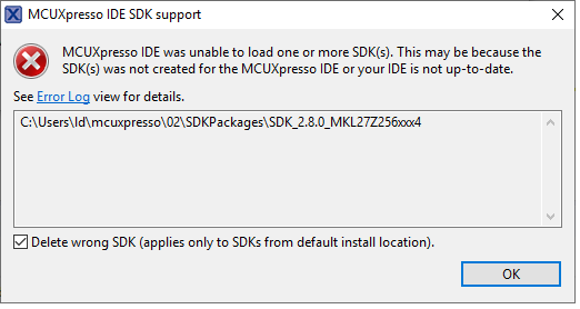

I get the following error when trying to install SDK for MKL27Z256. During SDK build I did select that it should be prepared for mcuxpresso IDE, and my IDE is updated. Bellow is the error message
further in the log file says that it cannot find a valid manifest file. At least the manifest file is present, but I do not know what is wrong

Hi Lasse
From the error message, your IDE is not up-to-date.
Please download latest IDE 10.2.0, and try it again.

Thanks Daniel! This solved the problem. I thought that the IDE was up to date because I was told so when I was checking for updates. Obviously the search paths for updates was not updated....which I would expected that the tool should handle on its own.
