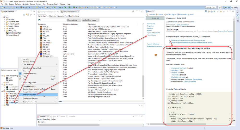

I am new to the NXP MCU family and need to know which tools to use to configure the clocks, pins and peripherals as well as which SDK to download for the drivers and APIs. There seems to be information on the MK60DN512xxx10 using MCUXpresso and the corresponding SDK.  From what I understand this processor is close but does not have an FPU and not sure if it comes with the 144 mapbga pin package.  Any guidance would be much appreciated.

Hi Larry,
Sorry for the inconvenience we bring you!
Although the MK60FN1M0VMD12 is similar to the MK60DN512xxx10, there is no SDK for the MK60\70 120MHz series.
MK60FN1M0VMD12 is not in the support list of KSDK and MCUXpresso SDK .
So I am afraid you may need to develop it by using the Processor Expert in KDS3.2.
If you have never used Processor Expert, then please refer:
Overview: Processor Expert
Getting Help on Processor Expert Components
There are several examples of typical settings and usage of xxx_LDD component. You can modify the setting in processor expert and copy the codes.
