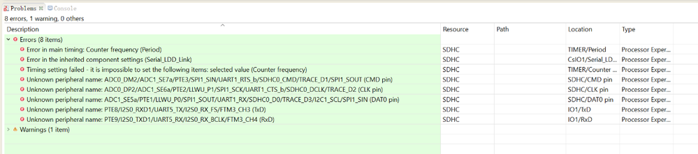

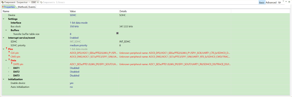

Hui_Ma
I checked you attached [SDHC] project with below error info:
Customer could refer Processor Expert [SDHC] demo example at CodeWarrior installation folder with below path:
C:\nxp\CW MCU v10.7\MCU\CodeWarrior_Examples\Processor_Expert\Kinetis\TWR-K60N512\SDHC
Wish it helps.

pedroortegasanz
Hi Hui_Ma.
Attached you can find the proyect whitout errors, but the problem persist……
