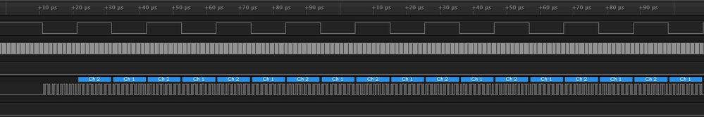

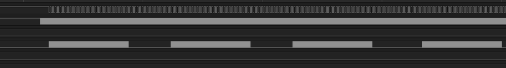

I have a few questions surrounding the attached simple example project transmitting I2S data against an MKL17Z256VFM4. First, is it possible to transmit continuously without delay using a circular ping pong DMA buffer without using 2 DMA channels? Does that require EDMA (not on MKL17)? Why doesn't the __asm("bkpt #0") breakpoint in main ever trigger (why does SAI_DRV_SendDataDma block?)
This looks good…
zoomed out - not so good:
