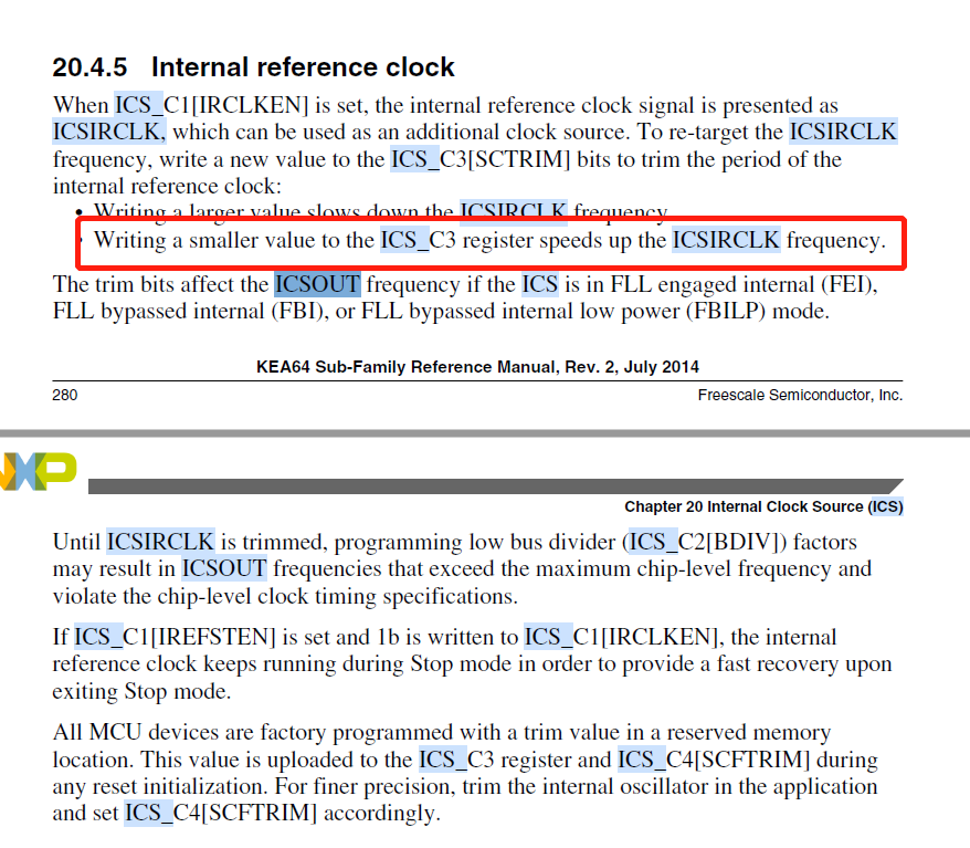

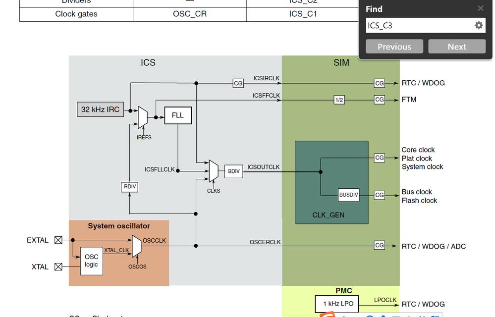

I do know that KEAZN64 has 1024 times the internal .   And from the datasheet, it shows internal clock from 31.25k-39.0625k. The typical value is 31.25k. This value is calibrated by factory .So we need to wite a new trim to ICS-c3.So could you please write ICS_CS =0; Please have a try.

I'm so sorry,I tried write ICS_C3 =0,but it didn't work.

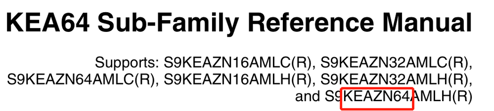

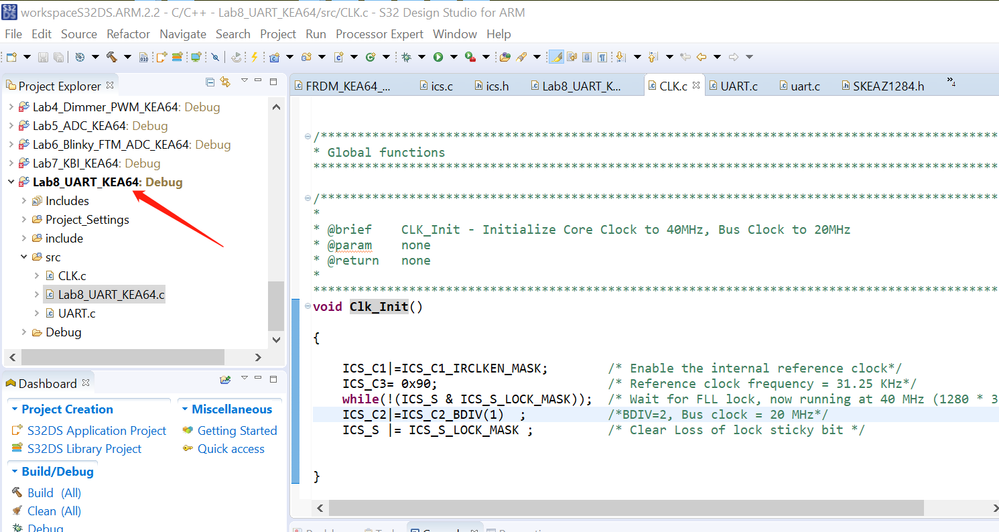

From the reference manual,KEA64 support  S9KEAZN64.
And internal clocking sources is from  31.25-39.0625khz. Which clock do you need to be 40khz.

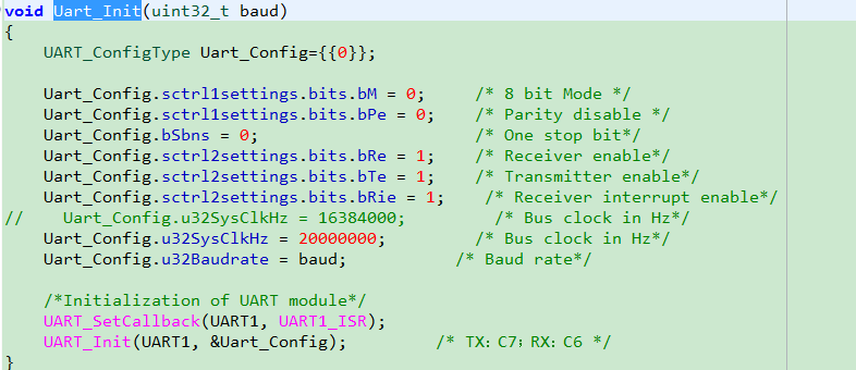

change the internal clock to 31.25 by config ICS_C3,core clock is 40mhz, bus clock is20Mhz.

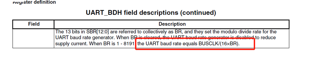

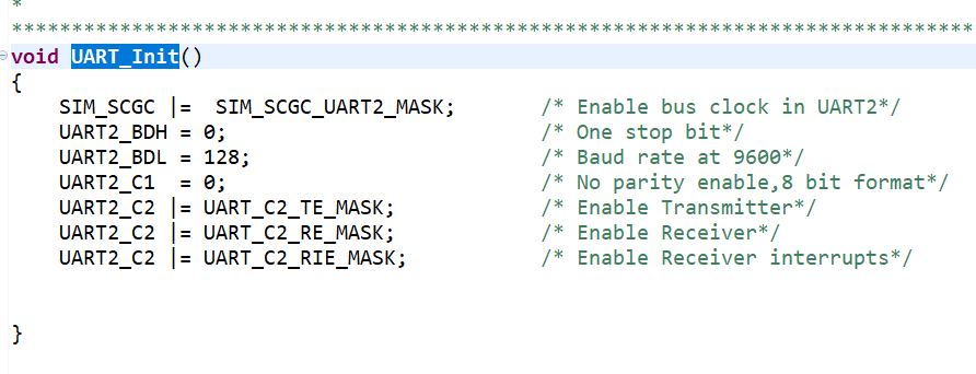

change uart2 to uart0. and change BDL to 11. The baud rate as shows in follow pic .pastedImage_6.png
Please have a try.

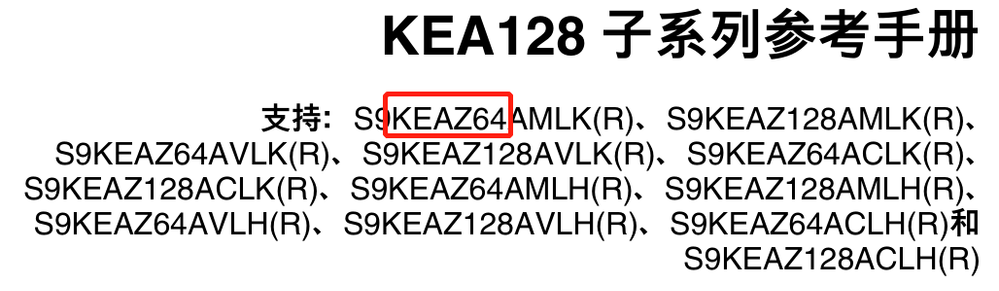

First, KEAZ64 and KEAZN64 are two manuals,and KEAZN64's clock is 1024*31.25, not 1280*31.25.
We configured the clock like this, as you suggested. But the test failed.

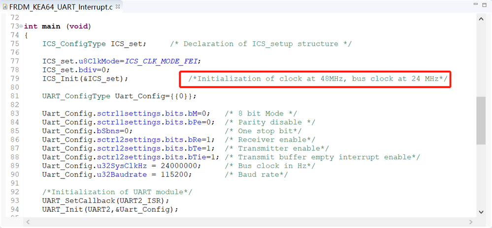

You can refer uart (FEI bus 20M baud 115200)code in "SDK-DRIVER-FRDM-KEA-S32DS\KEAZ64 Driver testcode and Examples (for S32DS)\FRDM-KEAZ64_Driver Testcodethis code" ,you can get it from attach file.

Sorry.
I opened the program,it's programmed with KEAZ64,but I used a KEAZN64.
It's programmed with a 48MHz frequency,KEAZ64 can be tuned to 48MHz at maximum frequency,but the KEAZN64 is only 40MHz.
