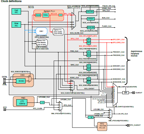

First let us see the clock tree:
Core clock up to 112M, Bus clock up to 56M, Flash clock up to 28M.
Clock can been from: System OSC、Slow IRC 、Fast IRC and System PLL

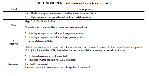

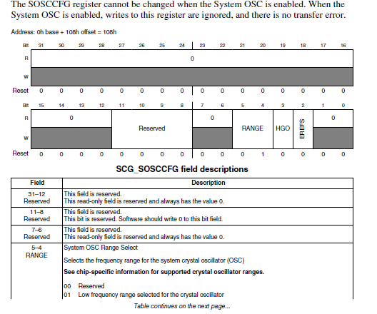

1. OSC
SCG_SOSCCFG

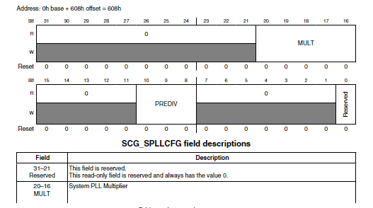

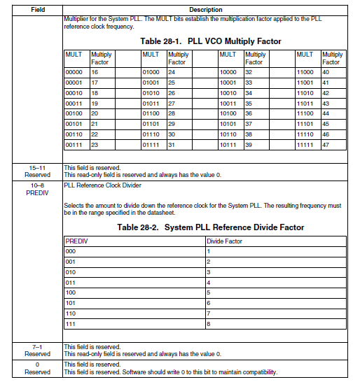

formula: SPLL_CLK = (VCO_CLK)/2
VCO_CLK = SOSC_CLK/(PREDIV + 1) *(MULT + 16)

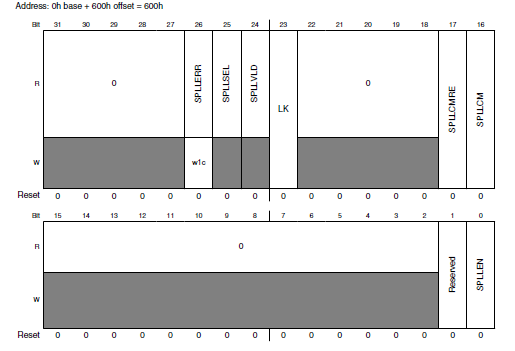

3. SCG_SPLLCSR

SCG->SOSCCFG = 0x3C;
SCG->SOSCCSR |= 1<<0; /* SOSCEN=1 enable SOSC clock */
/*wait clock active*/
while((SCG->SOSCCSR & SCG_SOSCCSR_SOSCVLD_MASK) == 0);
SCG->SPLLCSR &= ~(0x1<<0) ; /* SPLLEN=0: disable PLL*/
SCG->SPLLCFG &= ~(0x7<<8); /* PREDIV=0: 1 */
SCG->SPLLCFG |= 0xCU<<16; /* MULT=12: 28   PLL VCO = 8/1*(12+16) = 224M */
SCG->SPLLCSR |= 0x1<<0; /* SPLLEN=1: enable PLL */
/* wait PLL active*/
while((SCG->SPLLCSR & SCG_SPLLCSR_SPLLVLD_MASK) == 0);
