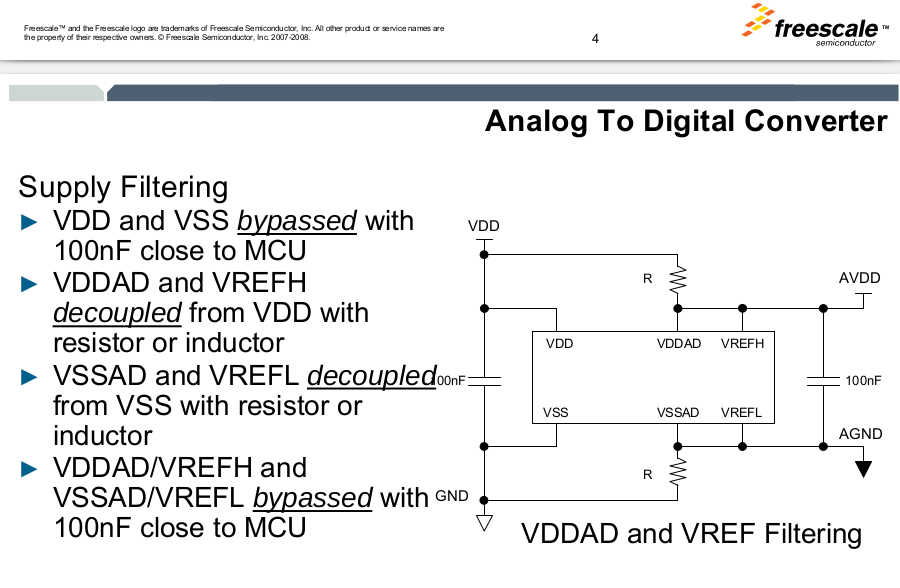

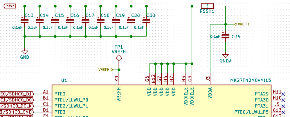

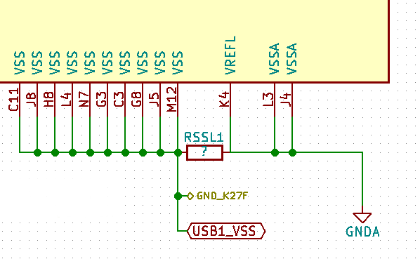

What resistor value can I use to VDDA decoupled from VDD, or what inductor?
For RSSH1 and RSSL1 in my circuit, at the end of this post.
Design Tips & Tricks for Analog
Functions on 8-bit MCUs
2,198 Views
jingpan
Usually we suggest a ferrite beads that have a small impedance (about 100 Ω at 100 MHz).
