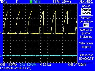

R_L_
I think I'm having the same situation (oscillating reset_b),  but to hold the reset_b to gnd during the powerup doesn't put the MCU in program mode.
I send a picture of the reset pin .
Im using Keil + U-Multilink + KL05Z. Does anybody has any idea to put this device into program mode ???

apanecatl
Senior Contributor II
The behavior you are all seeing is due to the watchdog status of the microcontrollers, before they leave the factory, every microcontroller's watchdog is enabled, therefore they will not allow you to program them since the watchdog is continuously resetting the device, while the reset cycle is being performed the Reset_b pin will act as a POR, if you show the signal in an oscilloscope you will see a sawtooth signal. It is perfectly normal, in order to program the mcu you need to drive Reset_b low and then power up the mcu, this will break the reset cycle, prevent the watchdog from executing and forcing the mcu into EZ programming mode, where you can program it normally, this only needs to be done once.
