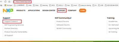

Where should we report issues in SVD files, e.g, incorrect offset or missing fields. Is there any place to submit a patch file?

Celeste_Liu
Hello @ri ,
Thanks for your post.
You can report issues here in the Community.
If you already have a patch file but prefer not to expose it in a public channel, you’re also welcome to send the patch to us via private support case. You can create a case here:
If you encounter any issues while creating the case, please feel free to reach out to me, I’ll be happy to help.
Once you provide the detailed information, I can take a look on my side. If I confirm that it’s a real issue, I’ll help report it to the internal team for further investigation and tracking.
Thanks again for the feedback.
celeste
