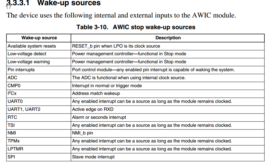

wenxue
Hi Kan_Li,
For PC host to wake up USB device(Kinetis MCU) in VLPS mode. But I found AWIC resource doesn’t contain USB wakeup on KL26.
So how to wake up KL26?
9,704 Views
Kan_Li
Hi Wenxue,
I think you have to use other sources to wakeup KL26 device under VLPS, for example, pin interrupt.
Hope that helps,
Kan
9,704 Views

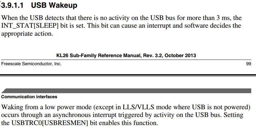

wenxue
Hi Kan,
Actually, customer need to wake up KL26 via USB.
I just want to confirm whether we can wake KL26 device under VLPS via USB.From the Reference Manual,it seems USB wakeup can be achived. But AWIC wakeup source doesn't include it. So I am very confused.
Wenxue
