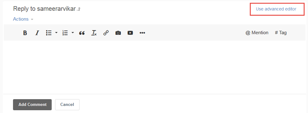

Please check below picture to use advanced editor to attach the project.
Ma Hui
