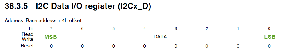

I have a problem reading data from the I2C1_D Register for my KL25Z.
I have when running in a while loop on the logic analyzer the 0x3A Data.
But when working with the start-stop-breakpoint debugging, I have other data in this register.
How is this register organized? Where is the least significant bit and where the most significant bit?
Thank you

Hello Ulrich:
Sorry, after reading your post I am not understanding your issue clearly. The I2C data register (I2Cx_D) is a single byte with bits organized in the conventional order:

us1
Hi @Jorge_Gonzalez
the problem I had: There was the wrong value in the I2C1_D Register!!! Sensor send the right one.
This was, because my code was missing the Dummy read!
NXP should add this to their handbook, if you work after the reference manual!!!
