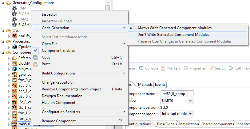

piergiusepperan
Ok, i put this code just below the Data=(uint16_t).... etc :
extern int16_t uart0_value;
  uart0_value=Data;
Now it works but the problem is that sometimes this part of code disappear and I have to write the code again.At the beginning of the code (automatically generated) there is this write: It is used by Processor Expert only; Do you know how to avoid the removal of the code: extern int16_t  etc?
4,297 Views
dave408
Senior Contributor II
Hi piergiusepperanieri​, you just have to disable code generation for that particular component.  See below:
