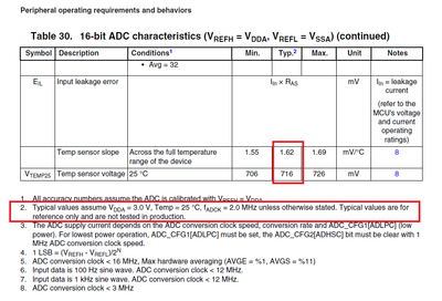

I had question about the formulas used.
The formulas use the temperature coefficient value and temperature slope value which can be taken from the datahseet but values in the datasheet are specified at certain conditions highlighted below.
as per my hardware VDDA is connected to 3.3V and the values specified are for VDDA = 3V
So can I use the above values directly in my implementation or I will have to calculate the values as per my hardware. If yes then how do I calculate the temperature coefficient value and temperature slope value?
Thanks in advance
Anuj
9,260 Views
_Leo_
Indeed, you can use that range of values for your implementation, since the specification for Temp sensor slope (1.55 to 1.69mV/°C) covers the entire range of VDD voltage values and 3.3V is within the range. Note that it won't be exactly 1.62mV/°C, but it won't go out of range.
On the other hand, I share with you the Application Note AN3031 , which is a bit old, but it will serve as a guide on how to calibrate the temperature sensor.
Leonardo
