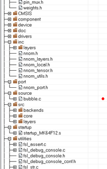

2.3 we select the example ‘bubble’ to add the Inc, port and Src folders in NNoM to the project, as shown in the figure
                     Figure 1
Open the file ‘port.h’ . The definitation of NNOM_LOG is changed to PRINTF (__ VA_ ARGS__ , Open the ICF file, and change the heap size to 0x5000, define symbol__ size_ heap__ = 0x5000;

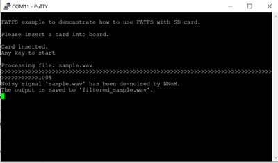

2.9 After the compilation is passed, download the program. The tested wav needs to be named ‘sample.wav’, and the mcu will reduce noise for it. Finnally mcu will
generate ‘filtered_sample.wav’. Plug the SD card into the computer to listen to the noise-reduced audio. This is serial message.
Figure 5

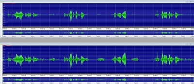

This is the audio analyzed by the audio analysis software. The upper part is the noise reduced, and the lower part is the original sound. You can see that a lot of noise has been suppressed.
                                                 Figure 6
