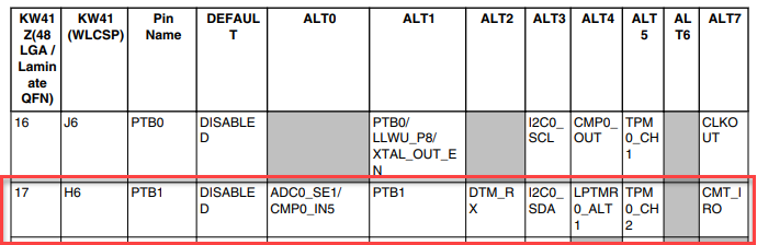

Sebastian_Del_Rio
Hi David,
Could you please let me know how is the Pin MUX being configured? Are you using ALT0 for functionality of your pin?:
Are you still getting the constant interruption?
Please let me know if you are still having issues with the SPI configuration.
Sebastian
4,334 Views
dave_harmonjr
Yes I was using ALT0 but the default project had a config for the ping to be an SPI Slave Data Available Pin which was causing it to get stuck on that when the code to cycle through the analog mux picked up a high voltage.
It was resolved by commenting out that code.
