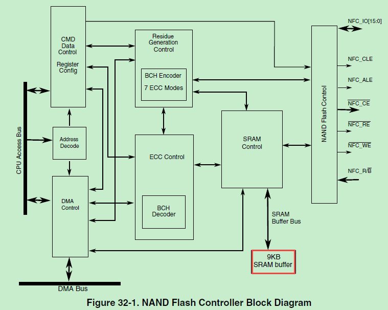

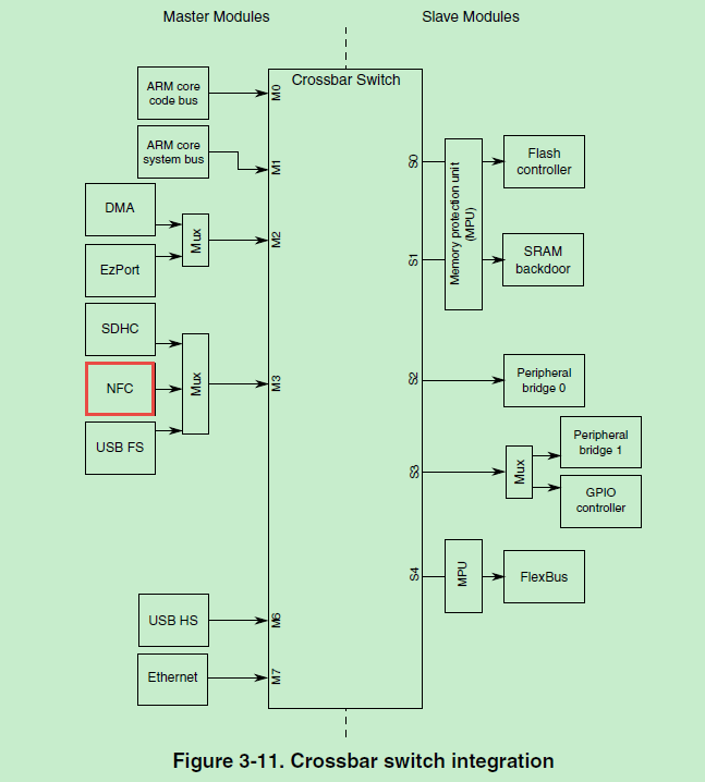

The MK60FN1M0 reference manual shows NFC works as crossbar master 3 with below picture shows:
While, the NFC block diagram shows the NFC module could only access the 9KB SRAM buffer, there without other crossbar slave access interface provided to NFC module.
That's why I said Crossbar Configuration without any effect.
There doesn't need software code to manage Flexbus and NFC operation, those work was done by hardware.
Wish it helps.
Ma Hui

1) You mean that NFC can only access 9KB SRAM buffer that is dedicated to it and it cannot access the FlexBus slave devices, correct?
2) Also, there is no need for software to modify/use Crossbar Switch registers for this particular interfacing case, correct?
Please confirm.
Thanks & Regards.
10,323 Views
Hui_Ma
Yes, both are correct.
Wish it helps.
