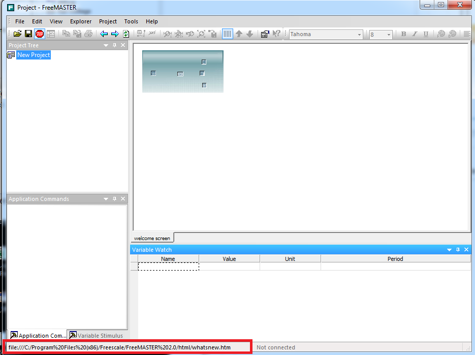

Hello Team
Could you check my problem of freemaster?

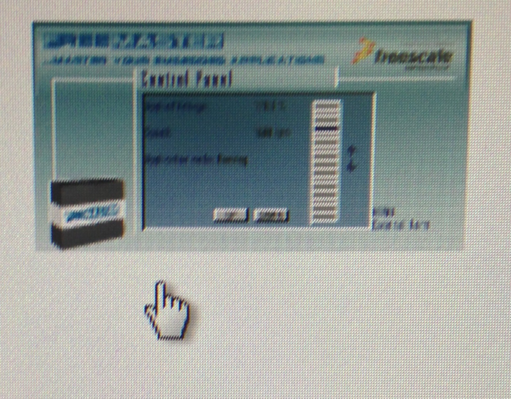

As you can see the below picture, my freemaster could not show HTML page for demo. It is just “welcome page”.
And you can see, I think that the information is available, the mouse icon is changed and it is possible to use the original function.  Only could not show the graphic showing…
And other demos, they could not show html pages also, so I could not support and demo for customer.
I tried to re-install freemaster but it could not fix it.
Could you provide any guidance for the solving it?
Thank you.

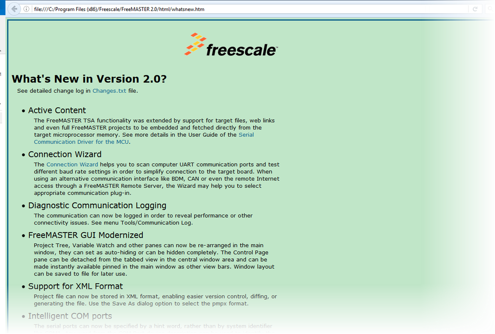

Hi Kwangsu Chun,
I can´t reproduce this issue, because it seems to be correct on my side.
Please, let me check some additional information from you.
- What is your update version? Is it 2.0.2.4 ?
Help -> About FreeMASTER
- Do you open the HTML page in a browser? Isn´t broken?
- If you set it manually - does it work you?
Please, go to Project -> Options and on HTML Pages you set the URL of the displayed page
Please, let me know your results.
