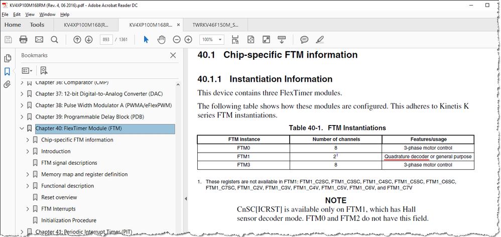

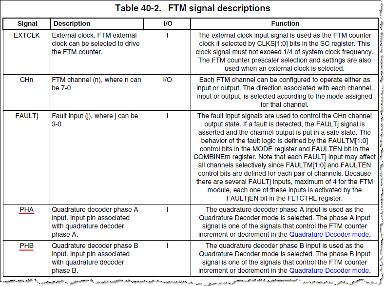

I am afraid you have to select FTM1 module which support Quadrature Decoder mode.
You can only find FTM1_QD_PHA and FTM1_QD_PHB in "11.5 KV4x Signal Multiplexing and Pin Assignments" of KV4XP100M168RM.

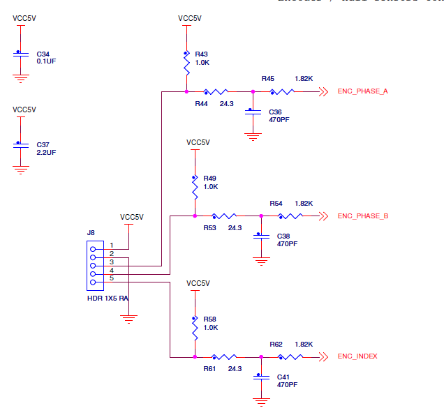

When I look at the twr-elev and twr-mc-lv3ph schematics, the position information from the encoder comes to the channels of FTM3.
This documents are found these websites.
Search Results: SCH-26820
https://cache.nxp.com/downloads/en/schematics/TWR-ELEV-PRI-SCH.pdf?fsrch=1&sr=1&pageNum=1
Search Results: TWRKV46F150M_SCH
the incoming signal reaches Ftm3.
Any suggestion?

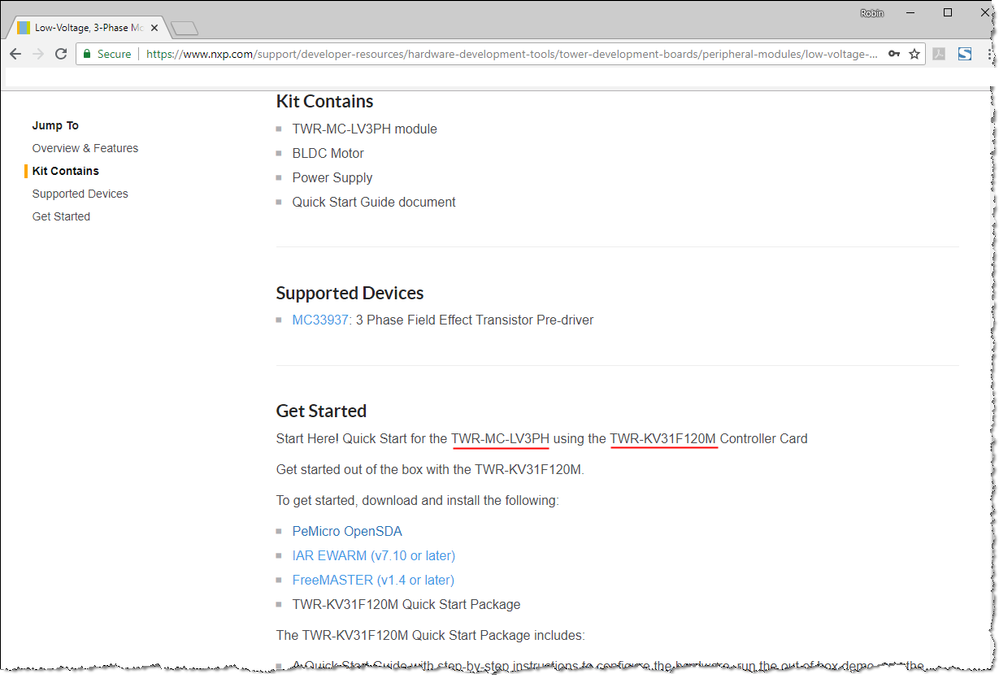

The Get Started of TWR-MC-LV3PH shows: Quick Start for the TWR-MC-LV3PH using the TWR-KV31F120M Controller Card.
I have check the A33 and A34 of TWR-KV31F120M_SCH, these two pins are connect to FTM1_QD_PHA and FTM1_QD_PHB(does support Quadrature Decoder mode).
But when using the TWR-KV46F150M Controller Card, these two pins are connect to FTM3(do not support Quadrature Decoder mode).
Sorry for the inconvenience!
