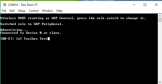

the glucose demo can be connected by the android ble app(like nrf connect ) and lightblue, but the wireless uart demo  will immediately disconnected from the phone apps...
here is the serial port log:
------------------------------------------------------------------------------ log from serial terminator ------------------
Wireless UART starting as GAP Central, press the role switch to change it.
Switched role to GAP Peripheral.
Advertising...
Connected to device 0 as slave.
Disconnected from device 0.
Advertising...
Advertising...
Advertising...
Advertising...
Advertising...

nxf51211
Hi Albert,
1. The code for the control of the switches is located inside the wireless_uart.c file.
     a) When you switch to GAP Peripheral (by pressing SW2) you define the variable mGapRole to  "gGapPeripheral_c" at      the funciton called "BleApp_HandleKeys":
 case gKBD_EventPressPB2_c:
            /* Switch current role */
            if( mGapRole == gGapCentral_c )
                Serial_Print(gAppSerMgrIf, "\n\rSwitched role to GAP Peripheral.\n\r", gAllowToBlock_d);
                mAppUartNewLine = TRUE;
                mGapRole = gGapPeripheral_c;
       b) After switching to Peripheral, you start advertising by pressing SW1 and the case redirects you to the               "BleApp_Start" function, where you wait for the connection:
        case gGapPeripheral_c:
            Serial_Print(gAppSerMgrIf, "\n\rAdvertising...\n\r", gAllowToBlock_d);
            gPairingParameters.localIoCapabilities = gIoDisplayOnly_c;
            BleApp_Advertise();
            break;
 2. Regarding your problem with the connections, the issue is caused by the fact that the iPhone looses connection while the board still thinks that there is one. This problem is caused by the phone and not by the board; in order to fix this you would have to develop a new app which would allow the iPhone to reconnect properly.
3. I'm not sure if you are allowed to use the IoT Toolbox for your customers; I'm still checking if you are able to do it (I will let you know as soon as I get any information). However, I do not recommend using it in that way due to the fact that the app is only for testing, and does not have the support for a commercial use.

nxf51211
Hi Albert,
Sorry if I don't understand, but what do you mean when you say you want to edit the code? The test project that you are using works as a chat between the board (through the terminal) and the IoT Toolbox (through your phone). If you type into the terminal your phone receives the characters you're typing.
Ricardo Delsordo

nxf51211
Hi Albert,
You need to first set your board as GAP Peripheral. I saw in your video that after you reset the board, you press only SW1; the board starts as GAP Central after reset, and when you press SW1 you start scanning for other devises. However if you switch to GAP Peripheral first and then start advertising your board (first press SW2, and then SW1) your phone should be able to detect the board. The first time you attempt to connect the board might take a few seconds.
PS: In order to make sure that you are set as GAP Peripheral, I highly recommend that you use a terminal (like I did on my first answer) so you can see the current state of your board, and also to see if the messages that you sent from your phone are received (like the message "IoT Toolbox Text"  that can be seen in the image I added on my previous answer).
